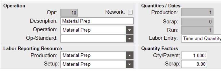

Basically require a little assistance with the last bit of a BPM (Pre Processing).
What I would like to achieve is once the data is submitted in the JOB.MTL table I would like to update the JOB.OPER table in the field QtyPer (Qty/Parent) ONLY where the OpCode = “MAT” with the following result from the JOB.MTL data formula.
