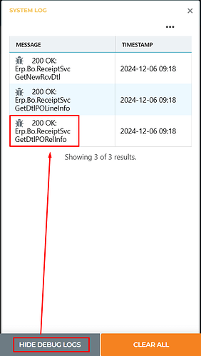

It looks like you have setup a BPM on Erp.Bo.ReceiptSvc/GetDtlPOLineInfo, but EKW is actually using Erp.Bo.ReceiptSvc/GetDtlPORelInfo to populate the form.

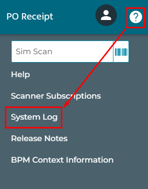

To help with making BPMs, I find it useful to use the System Log in EKW to view REST calls being made:

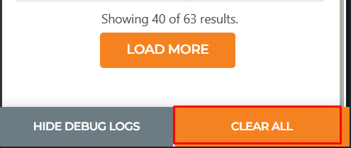

Then you can hit the clear button so you can just focus on new calls being made:

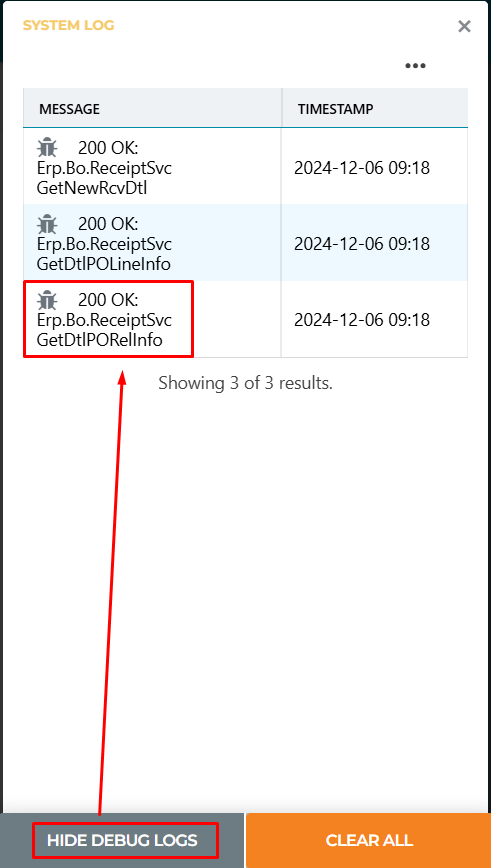

I then opened my PO line and re-opened the System Log and pressed to show the debug logs, and I can see the final call is Erp.Bo.ReceiptSvc/GetDtlPORelInfo:

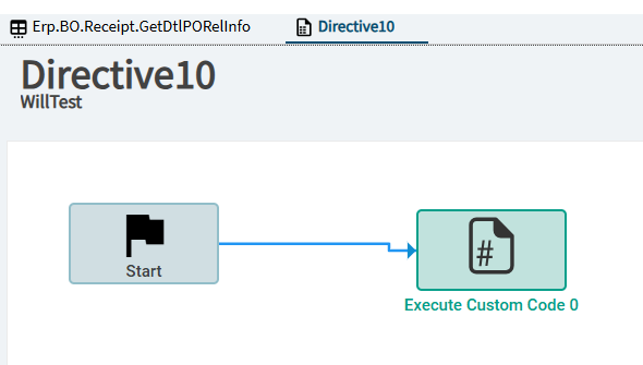

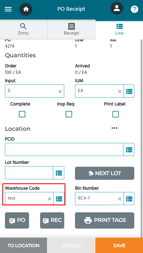

I then created this BPM which executes ds.RcvDtl[0].WareHouseCode = "test";:

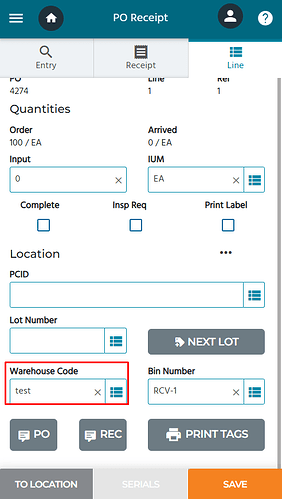

In EKW I then opened the line, and I can see the Warehouse being populated with “test”:

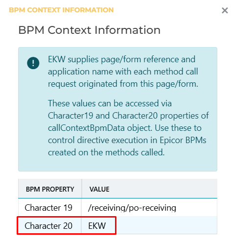

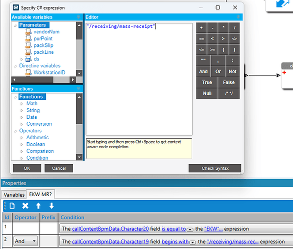

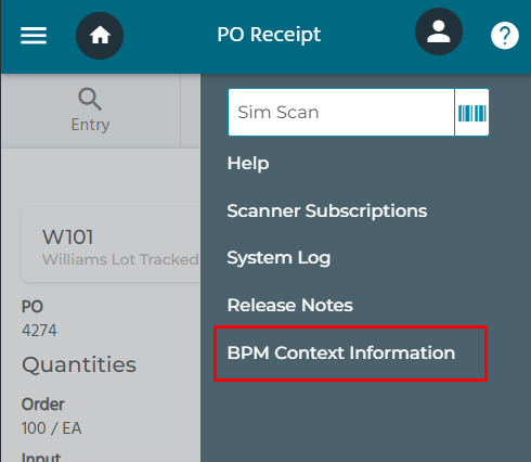

As a sidenote, to assist with maintaining logic like this on different calls, you may want to check the BPM Context on Character20. From EKW version 4.45.0 many calls will provide this info when making REST requests:

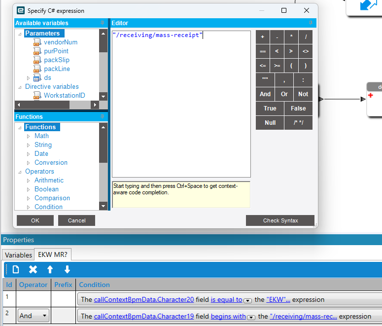

Then, in my BPM, I could use an if statement to check whether Character20 is equal to EKW so that my logic does not affect other clients like Kinetic.
Thank for the tips. FWIW, when I added the Character19 value for conditioning, in the Condition widget I had to use “Begins with” to get it to evaluate to True instead of equal to.
