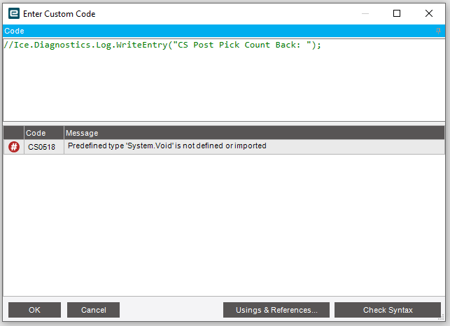

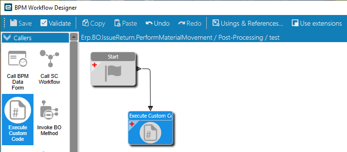

Can somebody put me out of my misery, and point me in the direction of what’s changed. I add an Execute Custom code box to any post processing method direction, and even with just a comment line it presents an error:
Predefined type ‘System.Void’ is not defined or imported.

Yep - if I uncomment the line, it gets even more excited:
Ice.Diagnostics.Log.WriteEntry("CS Post Pick Count Back");
