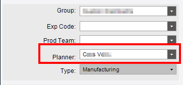

I have been requested to modify my current Post-Processing Method Directive to have the Engineering notification email sent to the person who is in this box. I have been trying to pull the UserID using the persons name, being its their first initial and last name I feel like this would be the easiest. However, I cannot figure out the best way to accomplish this. I cannot use Custom Code. Does anyone have any suggestions? I thought maybe using invoke BO.SysUserFile, but I couldn’t get it to work properly. I tried Fill table by query, but that again didn’t seem to work. I know for a fact its the User (myself) fault it isn’t working. So if anyone could help point me in the right direction, that would be amazing!!!

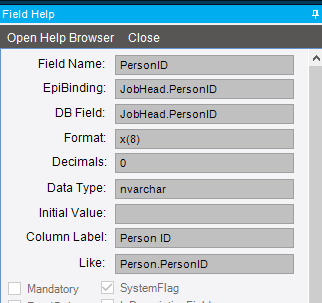

Have you used Field Help to determine the source of the control? The userID may actually be stored in that field. There are many places in the UI where the “code” or ID of the value is what is stored in the field, but the UI displays that code’s description or name.
Edit
That field does store the ID, in JobHead.PersonID
BTW - the email for that person is setup in the Person Maintenance. In Person.EMailAddress
So you want the record from the Person table where Person.PersonID == JobHead.PersonID

First off, it’s possible to create a Person entry that has no matching user account. This person could then be selected in Job Entry for the Planner dropdown. Your BPM would would never find a matching user for that planner.

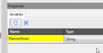

Make a variable of type string, like:

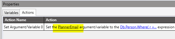

Add a Set Argument/Variable widget:
Select the variable you created:
In the expression, set it to:
Db.Person.Where( r =>r.Company == callContextClient.CurrentCompany && r.PersonID == dsJobHeadRow.PersonID).Select( r =>r.EMailAddress).DefaultIfEmpty("").FirstOrDefault()
Now you can use that variable anywhere in your BPM.

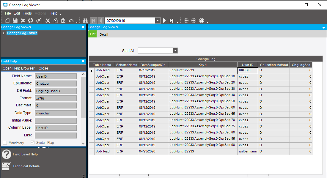

So if you were trying to pull the first UserID from the change log, would it be something like:
Db.ChgLog.Where( r =>r.Company == callContextClient.CurrentCompany && r.UserID.Select)
Or would you need to call out the Table
Db.ChgLog.Where(r=>r.Company == callContextClient.CurrentCompany && r.TableName == “JobHead”.Select (r=>r.UserID).DefaultIfEmpty("").FirstOrDefault()
Note: you were missing a ) between "JobHead" and .Select. And be careful copying code from this site as quotes often get changed to fancy quotes. Can yo tell the difference in the following:
Thank you for the warning, I wouldn’t have thought that would cause issues. However, I usually don’t copy/paste code because I like to type it out so I can really understand what is going on. To me it is like reading at that point. If I just copy/paste then I don’t really have the best chance of understanding what the code is doing and why. Also, I can see the difference but don’t really understand why it results in ‘Fancy’ quotes.
As for the code, do I need to tell it which change log like per the JobNum? The reason I ask is because I am pulling a ‘blank/empty’ value when there are numerous rows in the Change log.
The code sample I gave retrieves one record. So it is useful for finding a specific record, by adding more constraints to the WHERE clause part.

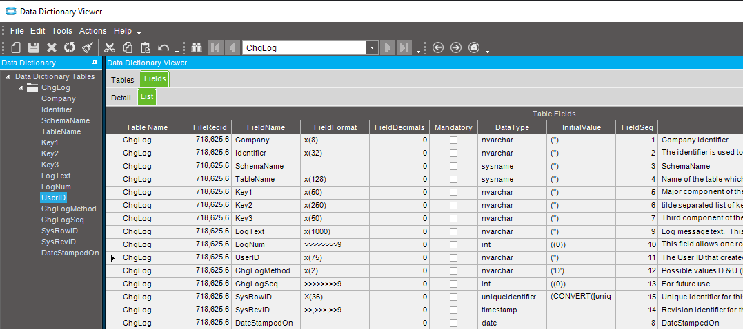

Adding more conditions should allow yo eventually find the record you’re looking for. Use the Data Dictionary to view the key fields of table ChgLog. Those are the ones you’ll want to include in your expression. You can also use the Field help (like you have shown) to verify the field names.
Off the top of my head, I’d guess the fields you need in the where clause are: Company, TableName, Date, Key1 (these might not be the exact field names).
Also, I am not sure how to call the DateStampedOn by the earliest date or first date. I thought of using Min or less then, but I cannot find any examples on how to write that. Anyways, this is what I have tried and what it has been returning. Did I write something wrong?

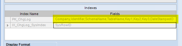

The key fields will be in the index table on the main sheet of the Data Dict.
For ChgLog, they are:
Company
Identifier
SchemaName
TableName
Key1
Key2
Key3
DateStampedOn
LogNum
UserID
You might not need to use all of those fields, But if you do, it guarantees to specify a single record.

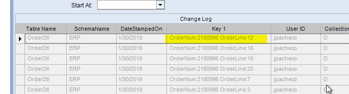

You clause of r.Key1 == "JobNum:"+ dsJobHeadRow.JobNum might need some tweaking. First, there might be a space between the colon and the jobnum. Second, you might need to convert the JobNum from an Int to a string before combining it with that text constant (JobNum: )
The phrase that returned, “Not Working” means that no record was found (meaning none matched the criteria)
Make a BAQ of the ChgLog table to see the exact contents of the ChgLog table - The ChgLog viewer might be tweaking the data for easier viewing. You could also try your criteria in the BAQ.
To avoid having to make an exact match of the Key1 field, you can use a Contains() in the where clause.
