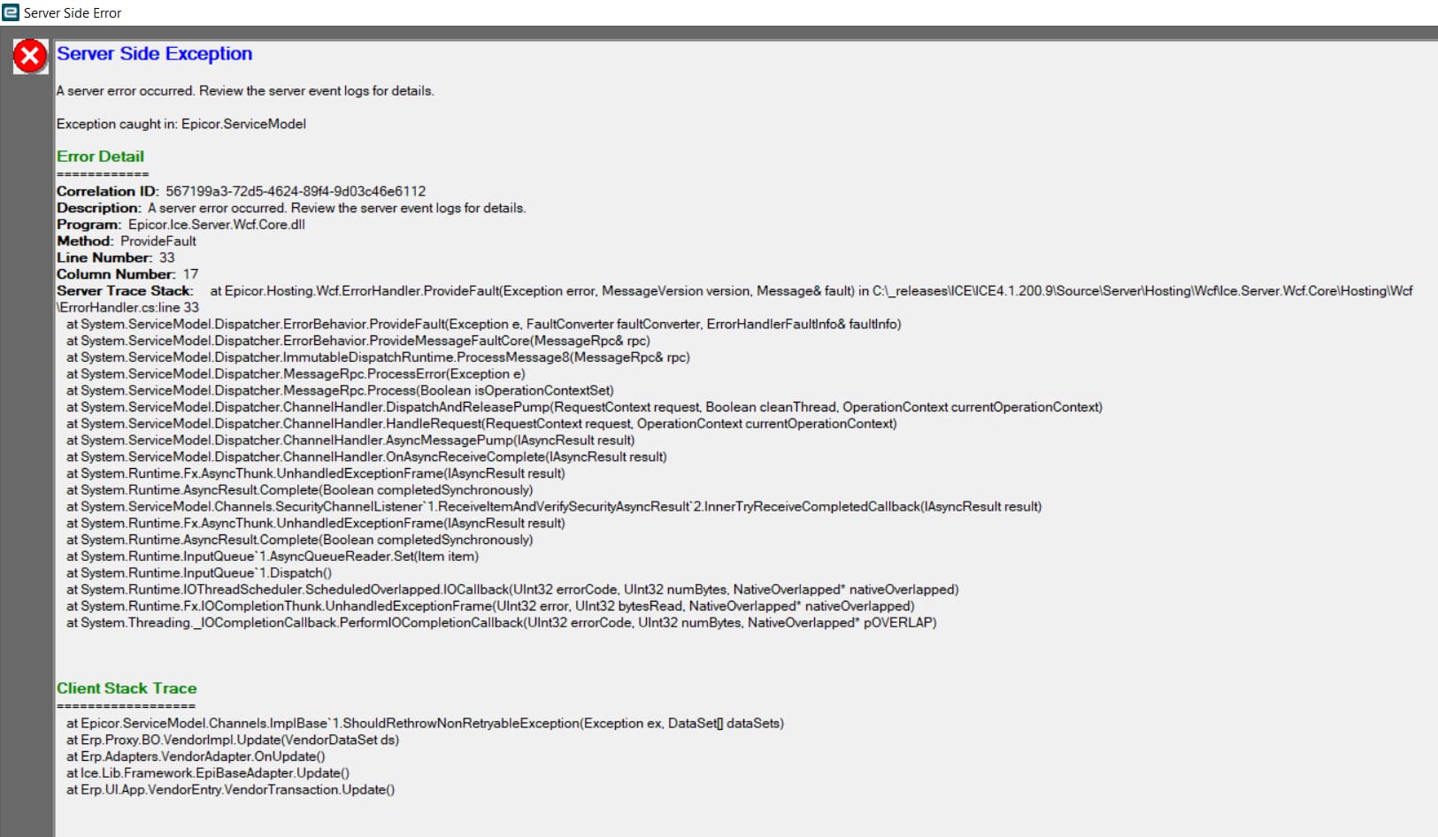

The method directive selected is Vendor > Update method and has a condition statement in place to catch whether the line updated is an added line or an updated one. I have troubleshot down through using message boxes and the BPM appears to follow the correct logic down to the C# code where we get the following error:
Based on that error I went to look at line 33 only to realize that there are only 31 lines of code. Then I thought to look at line 17 based on column 17 listed but couldn’t find any error on that line either. Does anyone have a method as to decypher what this error is actually looking at, and why it seems to be so angry?
I also tested to make sure that removing the c# code would allow the system to flow as intended, which it does. So the error is defiantly within the custom code. I have used this chunk of code in the past to write things to other ud tables but it works fine in those instances.
