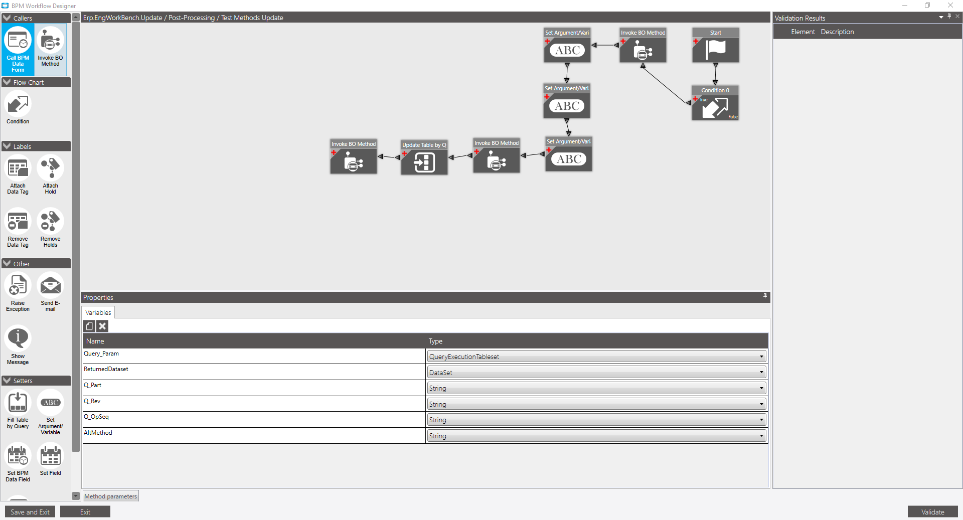

I am new to Method Directives, so please bare with me. I have been given a list of Part numbers that need to have their subcontract Days Out updated. Manually doing this will take forever and I do not have the ability to make updateable BAQ or Developer mode. Learning to use Method Directives to mass update/change parts would make my job so much easier.
Hence, I have been learning as much as I can on Method and Data Directives, but there is still a lot I am missing or not understanding. I have built several versions of both Pre and Post processing Directives. I have successfully checked out a revision to the Engineering workbench based on the part number in a query, but I haven’t learned how to cycle through the query.
Now I just need to learn the best way to cycle through a query of part numbers, check them out to a workbench, update the Days Out, check it back in and repeat. I should note that I have base access to these Directives, so some of the options are not available to me. I know this is still possible, just hoping someone can help me speed up the learning process here and give me some direction to help guide me to accomplishing this task/objective.
