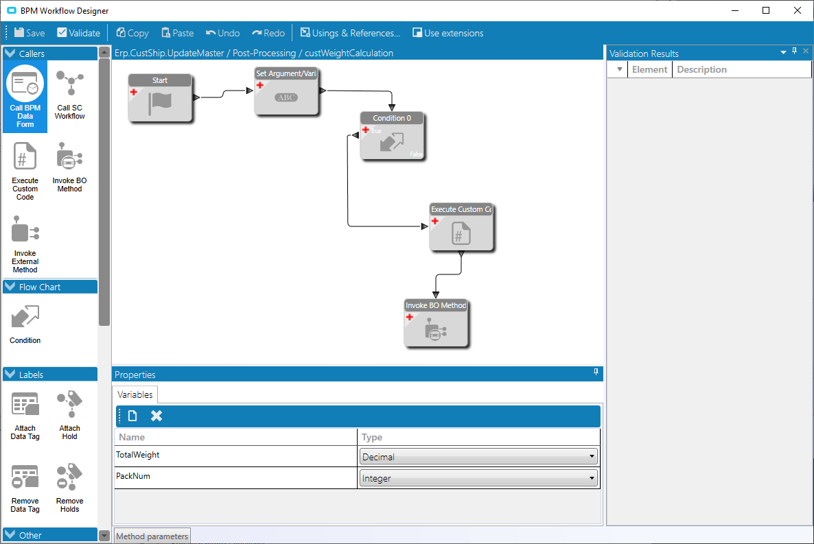

I have created a Method BPM but it keeps throwing up errors.
It’s been created on UpdateMaster for CustShip in Post Processing
Within the condition it look at Erp.ShipDtl is more or equal to 1
Invoke BO Method:
Custom Code is a LINQ Query to update a field on the table…

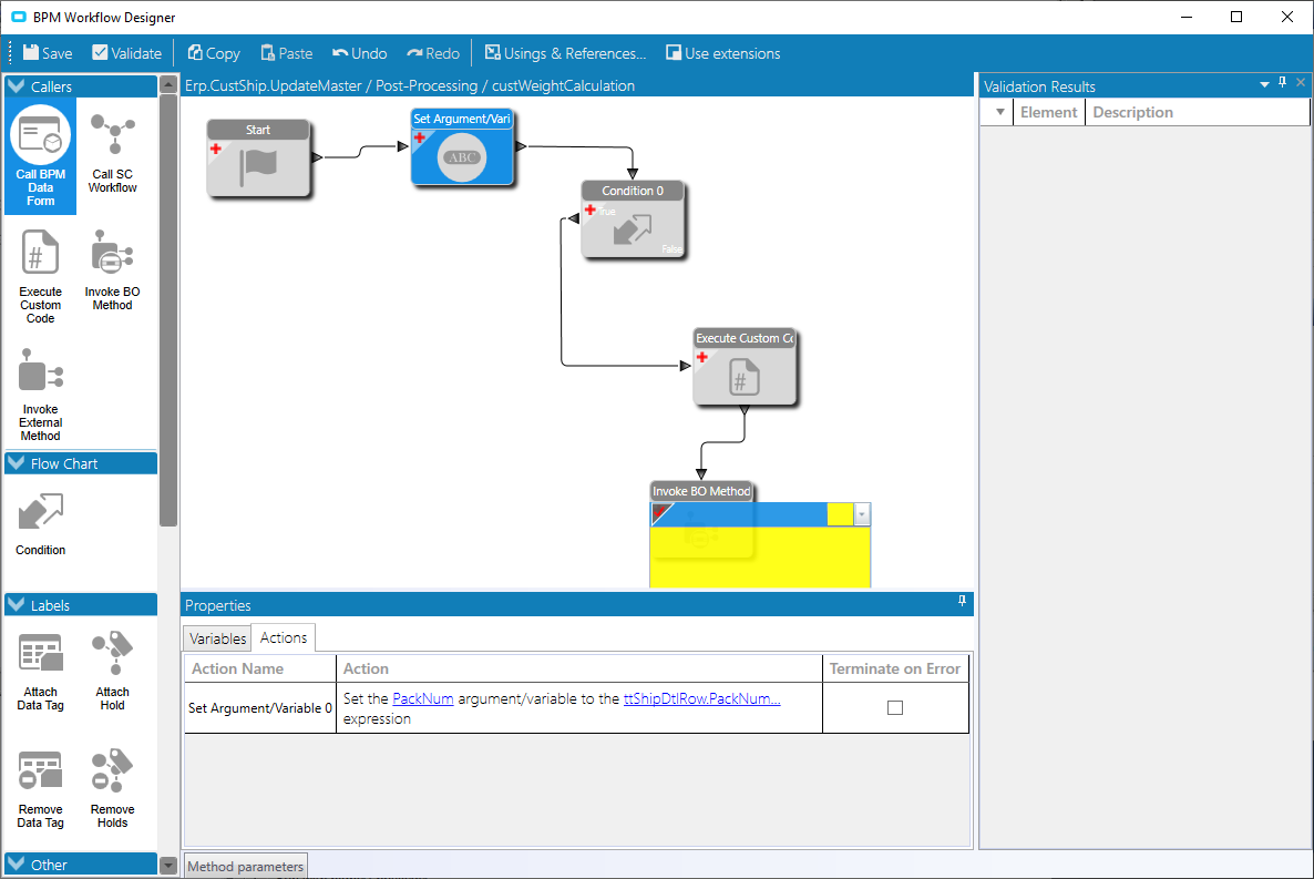

This method will fire when any part of the shipment changes, and it might be only the ShipHead record that’s changed.
The tt tables contain only changed records, so in that case there won’t be any ttShipDtl records.
Presumably in that case you don’t need anything to happen, so the easiest way to solve it is an early conditional with “there is at least one changed row” or “there is at least one added row” etc, for the ShipDtl table.
Which condition would that be I can’t seem to find those two terms…
You’re right, they’re only in pre-processing. My habit is to do tests there and enable the post-processing directive if the tests pass.
If you want to skip the extra pre-processing directive, then a simple “number of rows in the designed query” would do the same thing, and the query only needs to contain the ttShipDtl table with some field.

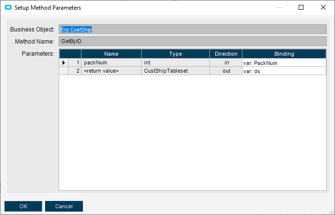

I have never heard the term refresh ds.Holder how would I go about doing this? Is it a BO Method I need to invoke?
I usually do it in custom code.
I’m assuming this is firing because of users working on shipments in the client? If so, a BPM which alters the record they’re working on means the client’s version isn’t the latest any more, so if they change something else and then save, they’ll get an error saying so.
The fix is something like this after your code has updated the records:
using (Erp.Contracts.CustShipSvcContract svc = Ice.Assemblies.ServiceRenderer.GetService<Erp.Contracts.CustShipSvcContract>(Db))
  Erp.Tablesets.CustShipTableset ds = svc.GetByID(PackNum);
  this.dsHolder.Attach(ds);
