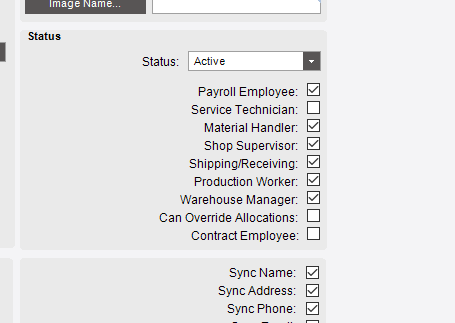

Does the EMPLOYEE that is clocking into MES have a USER account in the Material handler section of the employee record? from what i have seen, that is what prompts for the password when logging into the handheld or MES.

Yes. for Employees, anyone could clock in with another’s employee ID. For us that’s not an issue. the only control we need is for things that are controlled by the check boxes on the Employee record. so for those that issue material , they would have a password so we can control inventory.
For Employee that dont also have a User ID (90% of the manufacturing workforce) there is no password control. The only risk is one person clocks labor for another.

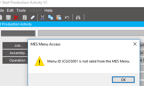

thats not a risk for us. we have a sec group for all the menu items. the MES user account only has the Production Sec Group so can only access the certain areas.
if a user tries to right click open with they will be blocked by the menu item security groups.
