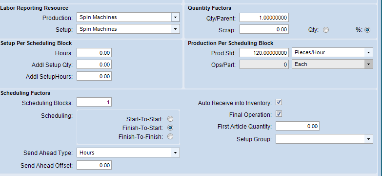

Hey all, I’m doing some testing with jobs on the MES for Epicor. I’ve set up some parts and BOMs from scratch.
There are 2 processes to manufacture this part.
The way the BOM is setup, three pieces create a subassembly, and then that subassembly is used on the next process to create an assembly that is shipped to a customer.
The process I’m following in MES after job creation:
Clock In
Issue 3 Child Materials to job
Report Quantity
End Activity
(This seems to move the 3 pieces into WIP correctly, and after reporting puts the manufactured piece into WIP)
For the second operation on the job:
Clock In
Report Quantity
End Activity
Final Operation/Auto Receive into Inventory is checked.
This puts the correct quantity into Inventory, but looks like it subtracts double the amount from the previous piece put into WIP.
As an example, if I have 50 WIP pieces and report a quantity of 10, 10 pieces are put into Inventory/Stock, but 20 are subtracted from the WIP.
All the quantity/parent are set up as 1, what do I need to double check so I can correct it?
Thanks!

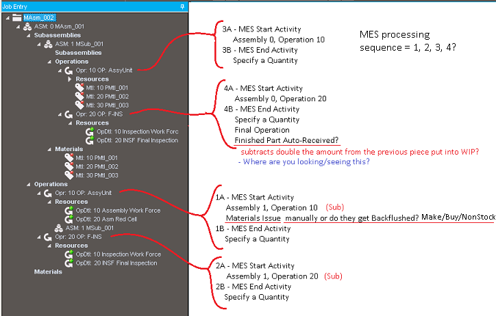

I don’t think I’ve ever seen results like those you describe from a setup like that.
Just curious where are you checking the “amount”?
And if you can give us any more details…what the job tree looks like, material types, MES processing sequence?
e.g.

And just wanted to verify where you are seeing the doubling?
The finished part number?
PartTran qtys or are you looking at some other report or tracker?
