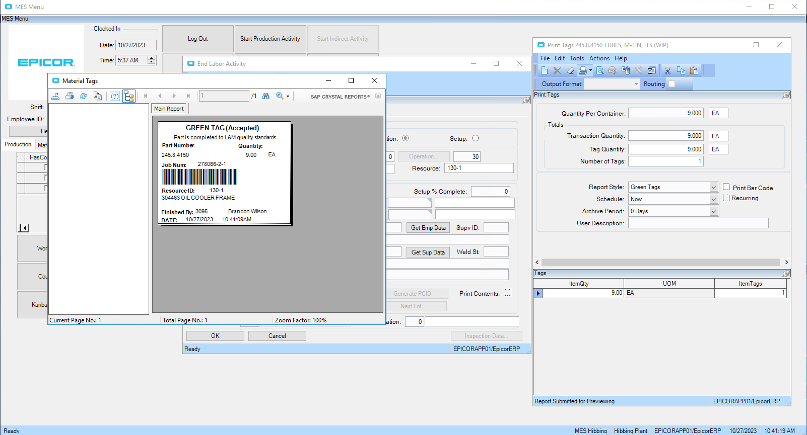

2-Brandon goes to start production activity on Job 278066-2-1, then ends activity on that job. He fills in the quantity of 9 and clicks print tags.
3-All the data correct carries through to the print tag screen where he chooses server printer, and the tag prints out.
4-correct tag is printed.

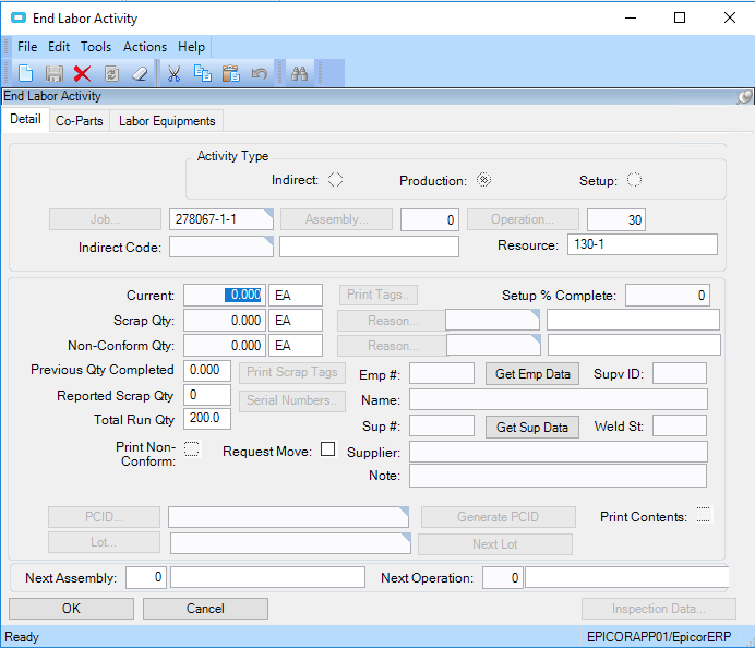

5-Brandon goes to end Job 268067-1-1 and fills in the quantity of 45 and clicks print tags.

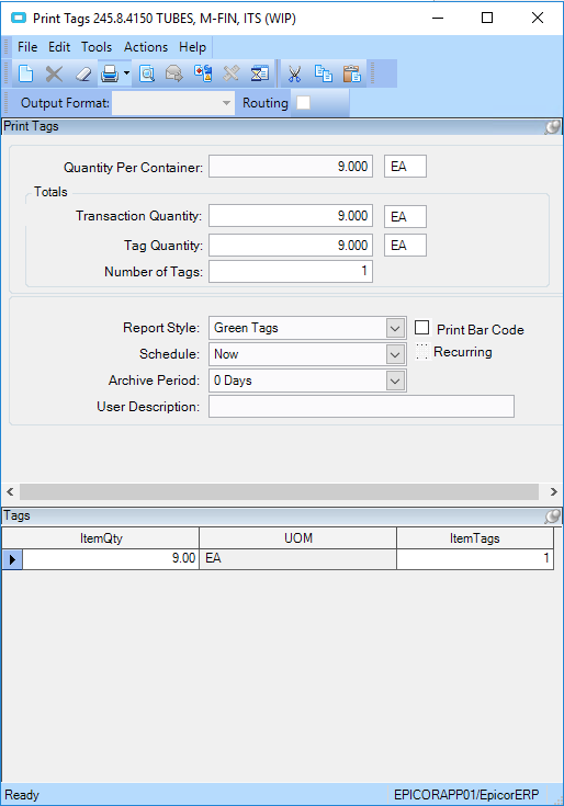

6-when the print tags screen pops up, the previous quantity of 9 is in the field, and the header of this window is the incorrect part number. It reads 245.8.4150 from the previous job, even though it should say 245.11.4675.
7-when they print the tag off, it still has the old job and all of that data with it printed.

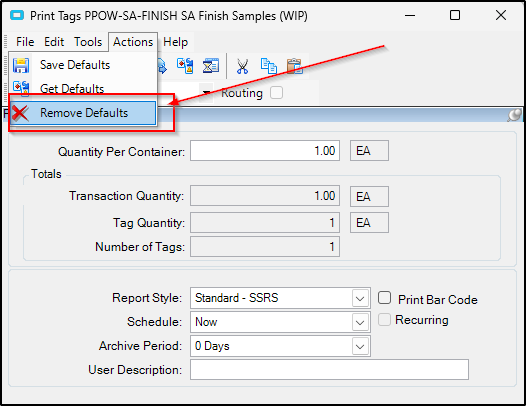

Did someone save defaults on the tag? Try going into the tag and removing defaults and see if the tag prints correctly.

From your screen shot on your 278067-1-1 job it looks like you are reporting “0” qty. Does it print correctly if you enter a qty >0?
Yes. Only when the first person makes a transaction in MES though. Then everyone after them gets the same tag that is printed from the very first person. I am on the phone with Epicor and we did try dev mode and base only on every screen. That seemed to have fixed it, but my question is why? There must be a customization that is messing something up right?
