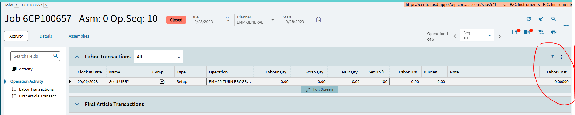

Hoping someone can assist me. I have created a layer in Job Entry to hide Labor Costs in Job Entry and Job Tracker(s) and applied layer to all 9 Job Tracker’s and Job Entry in Menu Maint. due to confidentially of employees’ wages. We left the Job Entry under Exec Analysis open as this one is restricted to sr. management. My problem is opening Job tracker through MES, which does not have the layer applied to it.

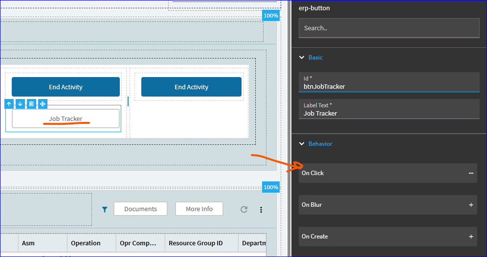

You’ll need to customize this WITHIN MES.

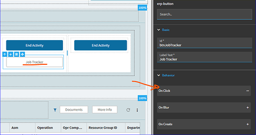

Find the event that is opening the Job Tracker…
Find the button, click Properties > Behavior > On Click:

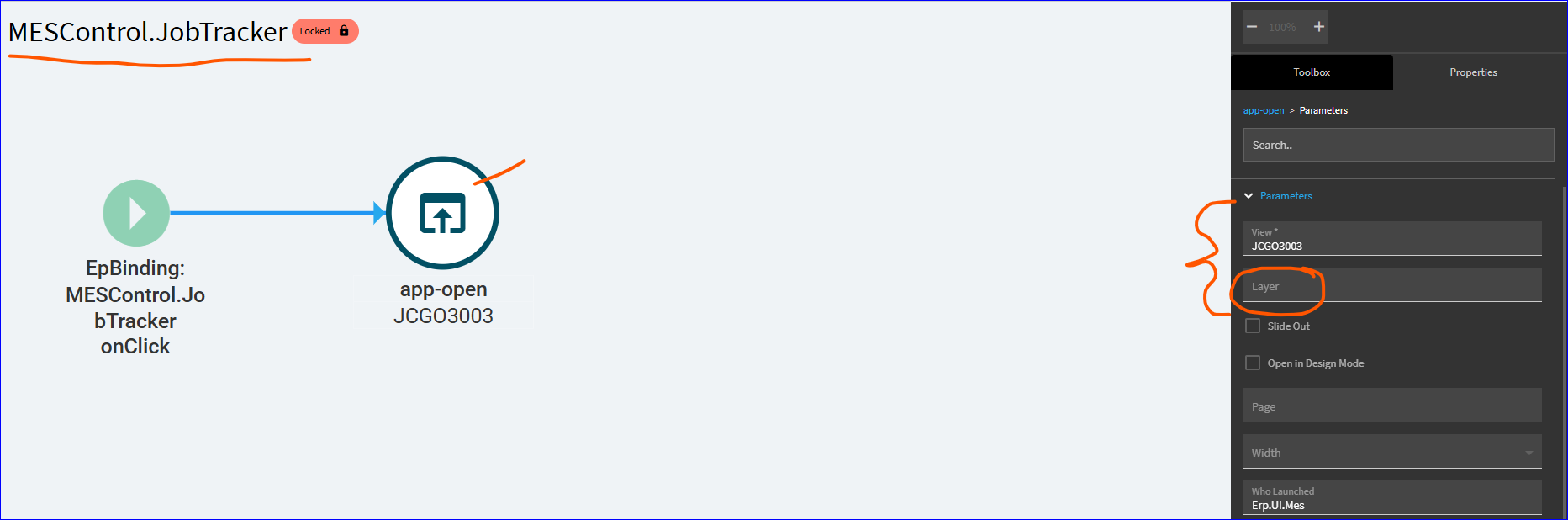

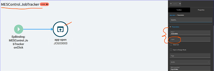

It will open the event that is opening Job Tracker via App-Open. If you look at the properties of that app-open widget, you’ll see the Job Tracker MENU is being called… but your customized layer is NOT applied:
You’ll need to copy that event (because it is a base event and cannot be modified).
Set the trigger on your new event to override the base event.
Add your layer to the properties of the app-open widget.
… and that should do it. Test and publish.

If we’re looking at the same base event… on your copy, set the trigger to:
Type: Event
Hook: Override
Target: MESControl.JobTracker (the name of the event you are overriding)
If you don’t see the Override option, let me know. It is there in more current versions, but older versions it had not been provided yet.

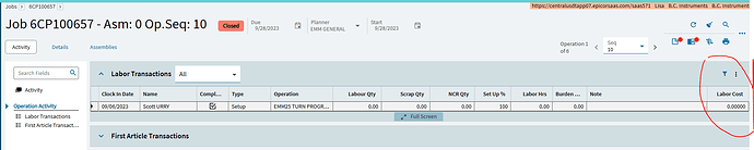

When I log into MES through Data1, it is no longer visible. Just an FYI, If I log into MES as myself, it somehow overwrites it to my personal settings (access to everything) Should it not be a constant? I was not aware that personal settings get ported to MES?
Hmm… I would have thought it would be consistent. That new event is telling it to open a specific menu with a specific layer applied.
You could try clearing your browser cache. I wonder if it is using a cached image when it is loading MES through your user name… or just try a different browser and see if it is any different.
