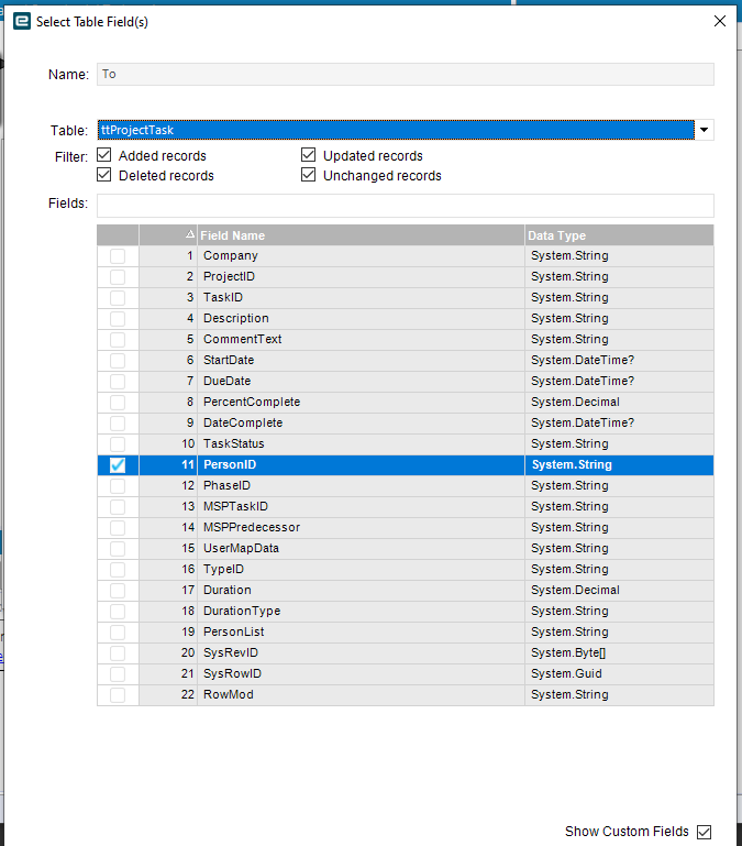

So, we created a BPM workflow design. But we cannot see any email id column.
So how can we fetch the email ID from this PersonID field?
You have to add a caller to run some custom code to grab the email address.

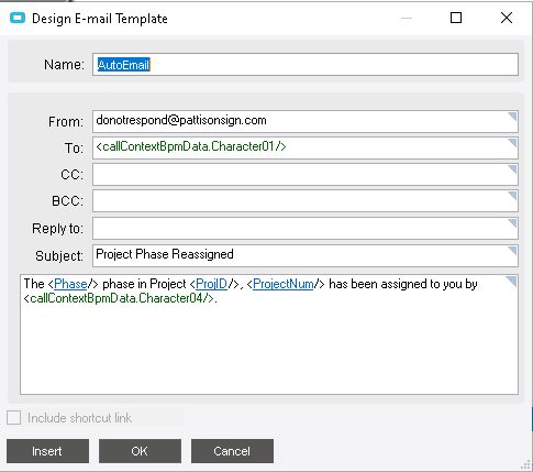

Thank you for your reply @rnewell .
Could you please also share your email design template if possible.?
Rishi
Thank you for your help @rnewell, i’ve tried it and the syntax was also valid but somehow, the mail is not received by the concerned person.
If you test with an email address directly in the email template does it work? Do you have any other auto email that works out of Epicor? We also test with a message box to confirm the correct email address is being passed.
Yes, it works when we use the direct email address. We might have another software that uses auto email. Is that might be a problem?
As long as Epicor is sending the Email with a direct email address then we know you have the Company Configuration and your SMTP server setup correct so no the other software would not be an issue. So if you have a direct email and the other in the CC: field do it show the right address in the email when it arrives at the direct email address? It sounds like the email is not being formatted exact in the code possibly?
Yes it shows the correct email address, with correct formatting which we had defined for the direct mailing.
