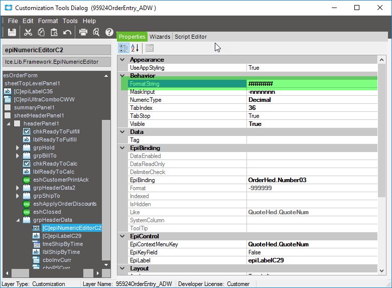

Try customizing the form and setting the mask to #######
The screenshot below is from Order Entry, but before putting in the mask, the field would show a single zero. After masking it, if the field is zero, it shows blank.
The principle should be the same in MES.
