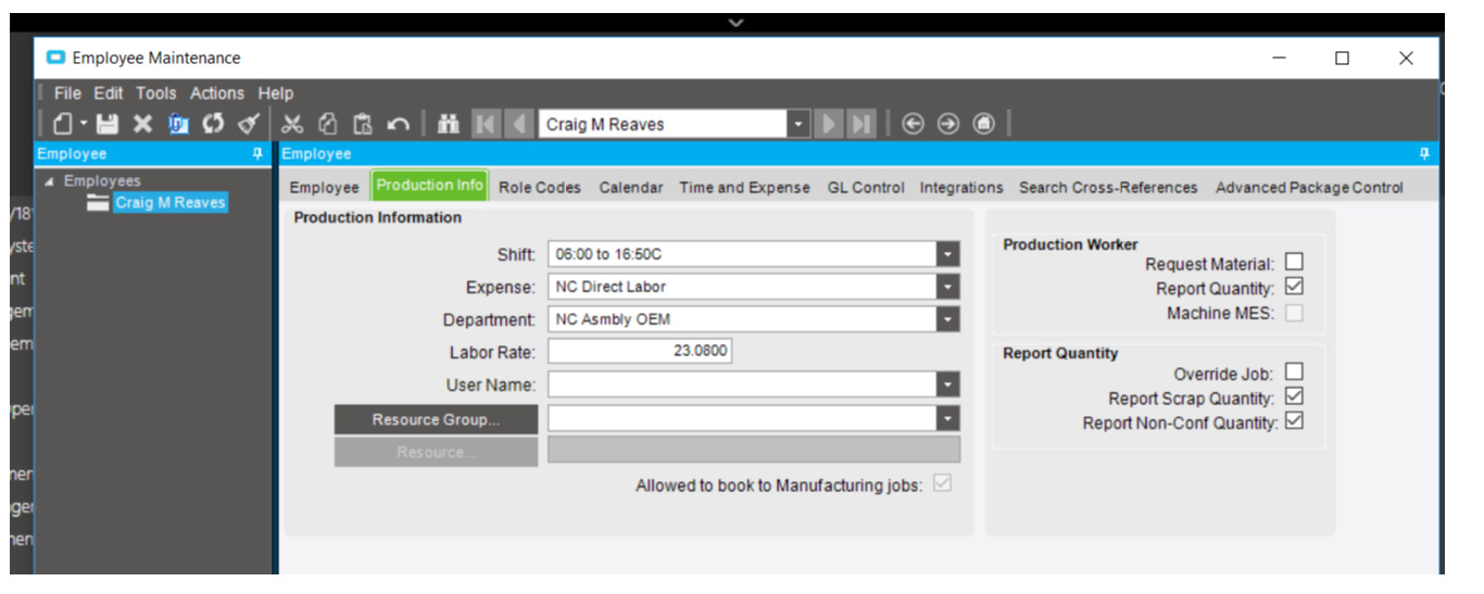

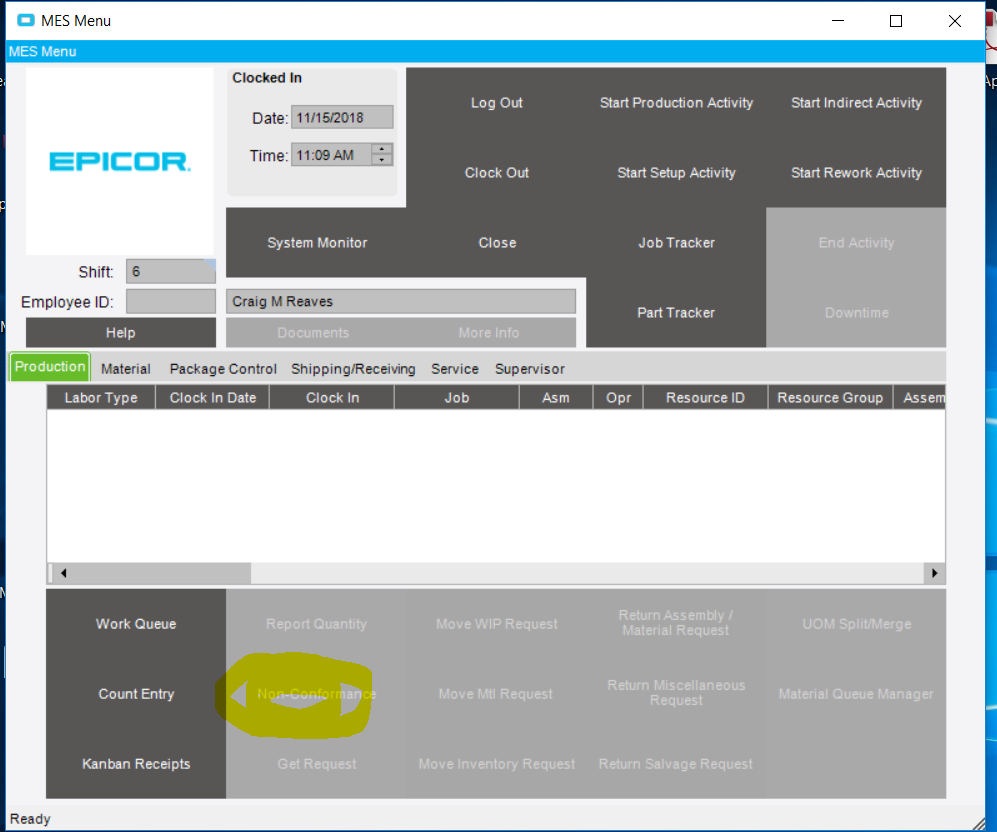

We are testing E10 to go live in 2 weeks. We have a group testing MES this week. They have reports a few buttons not active in MES. Has anything changed in E10 to active buttons in MES. THe user has Production Worked checked but is missing the following buttons…Non-Conformance and Request Entry (under Service)

Check Employee Entry - Tab: Production Info

Ok thanks. I did try some of these on the Employee Record.
I was able to active some buttons but I noticed the Non-Conformance was grayed out. I can’t modify it at all for the user. They are set as a production worker in Employee maintenance.
I do have those checked and the Non-Conformance is still unavailable. I must be missing something.

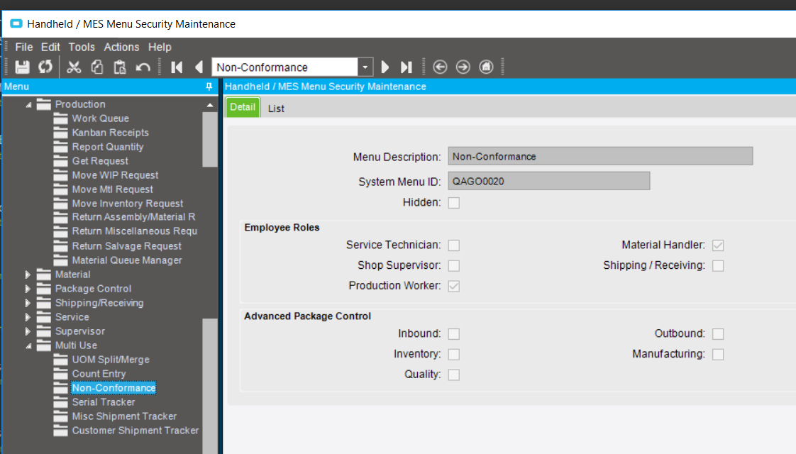

In my case it only is available if the user is a “Material Handler”, perhaps it is only meant for Mtl Handlers
I added him as a material handler but still not active.

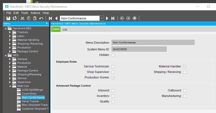

just odd because under MES security Maintenance the Material and Production are checked.

In menu maintenance -I’m assuming the menu structure is still the same - under production management | data collection, reset permissions for all sub menu so that all users have access.

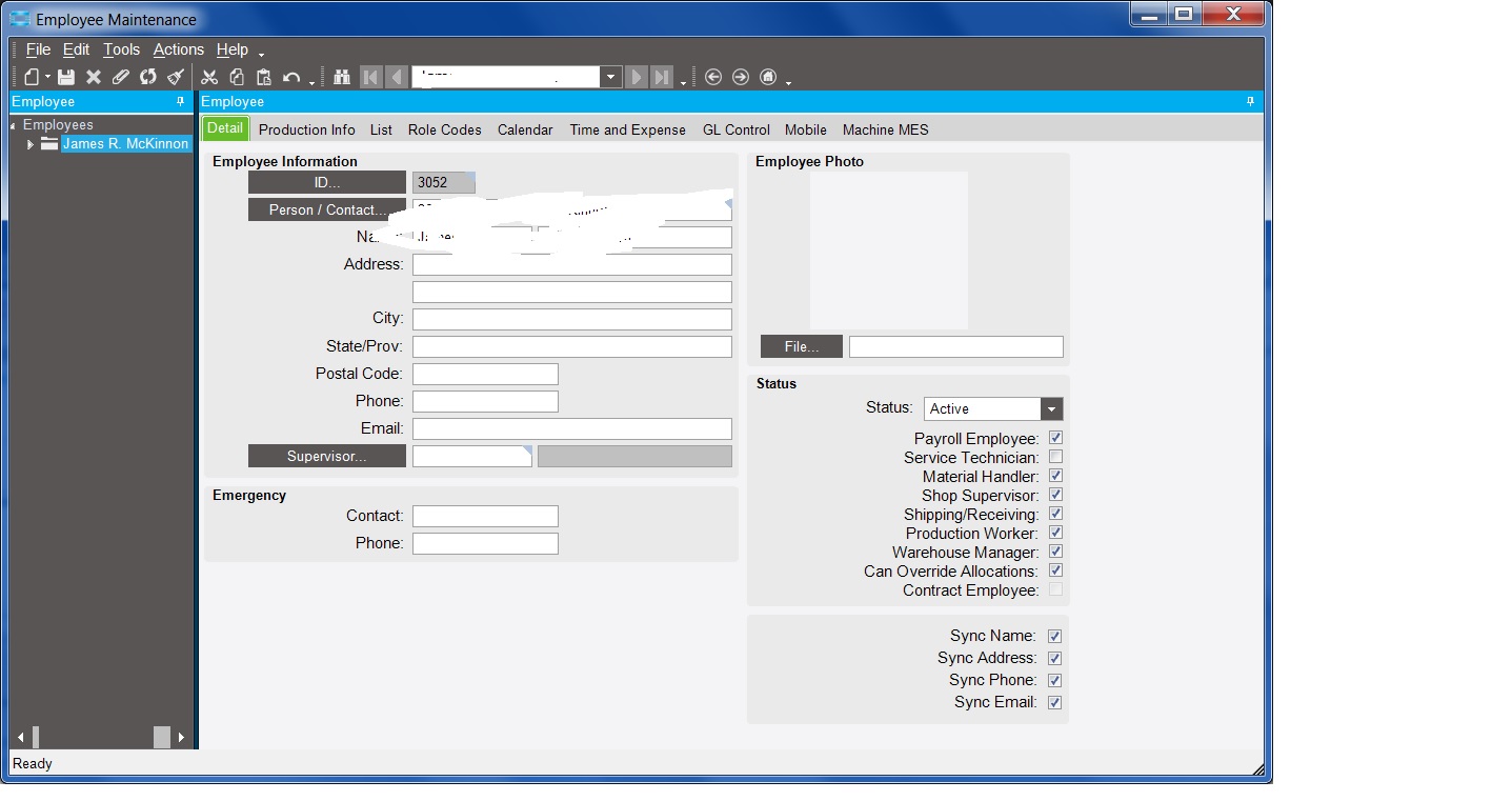

Also one thing you haven’t shared a screen shot of is the detail tab for the employee record - the associated roles need to be checked against the employee - can you confirm.as per below - we are on a slightly older version on E10 than you but principle should be the same

I can replicate what you see when I go into the employee tab of the employee screen and remove everything but the production worker selection from an employee - irrespective of whether you have selected report non conformance on the production info tab. If I subsequently check material handler on the employee tab the logged in user has extra buttons including non-conformance.
Can you confirm that you have you tried checking the material handler field for the employee you are testing with?

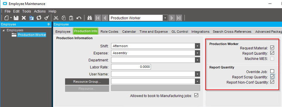

What do you have checked on this screen for the employee? I can confirm this works in 10.2.300.3 and these are the check boxes that control this. Report Quantity must be checked to enabled selection of the others. If still grayed out can you launch non-conformance from the regular menu and save an entry?
