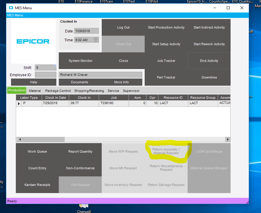

I have a MES user that can’t access a button on the MES Production screen.
The employee is set up as a Production worker and the Production check box is check on the MES security. What am I missing??

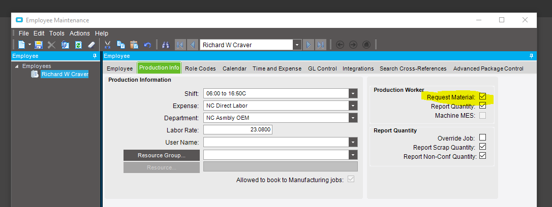

I’m not 100% sure, but I think that one is under the material handler permissions.
EDIT: Nope that’s not right.
It’s this checkbox that turns that specific one on.
that is checked on the user.
Are you 100% sure you are in the same system? I found a user that it wasn’t active for, and I checked the box, then when I log back in, it’s active. Something else weird is going on.
yes it is already checked…
I even went in an gave access to the users security group in the menu for Return Assembly but I didn’t see a Material Request menu item.

Just another thought to double check. Do you have Advanced Material? I believe Return Assembly/Material Request is part of AMM.
I had this issue a few weeks ago.
It was because I had the username populated here:
When I remove it, the permissions worked fine.
no we do not have AMM. It was working once before when we tested something so not sure what happened.

i know we are not licensed for AMM.
Try checking the Material Handler box
so evidently i have found out that someone made a customization or change to the config file. SIGH nothing like communication.
