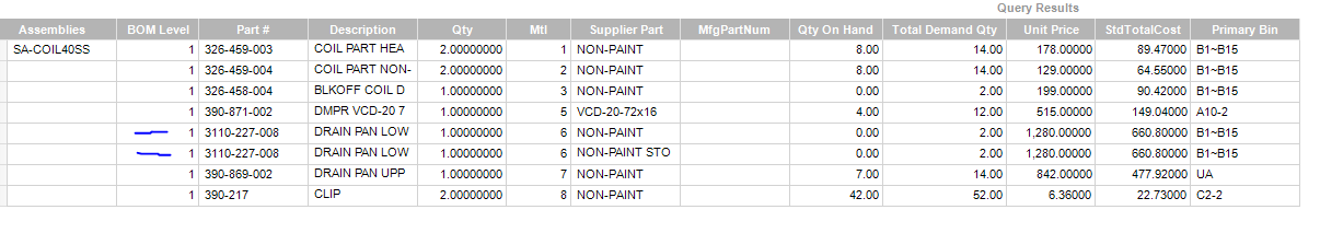

Hello All!
I am finishing up some tweaks with my Indented BOM BAQ, and one of the things pointed out to me is that we are returning multiple rows for parts when there is more than one supplier part number. I understand why this is happening, but we don’t want it to. I wanted to know if it was possible to actually “merge” duplicates with commas separating the two results? Everything would be unique except the one column. If not, I would just like to return the first result. I did some reading up on it, and nothing I seem to do allows me to just grab the first result.

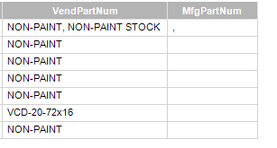

@Banderson thanks this seems to work! Now, how do I make it so that it won’t show a comma in an empty row? Just do a case when VendPartNum = “”?

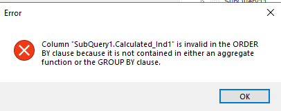

Also, I have two calculated sorts that won’t work anymore once I’ve moved most of my fields to my top level query, saying that they are not part of an aggregate function or order by clause. Any idea about this? If not I can look more into it
You should only have that if you have rows coming back with no vendor part number. You can filter them out of the table if you don’t want them to show up.

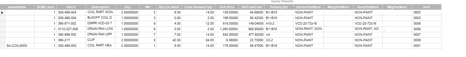

@Banderson to explain it better, I am using both VendPartNum and MfgPartNum, both of which could be empty for a given part, or have multiples. Here is an example of what I see, and FYI this is after creating two calculated fields, one for each with the code you sent.

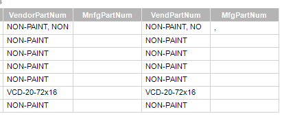

@Banderson seems to play well enough, and removes the comma on empty. However, how do I stop from showing all four calculated fields?
What do you mean? If it’s in the BAQ, who cares? Just don’t display it on the dashboard.
Or put your calculated stuff in the actual calculation, don’t reference it outside of the field like that.
True lol, I will remove that at load time. On another note, for some reason my calculated field sorts no longer work, but I think this was after I moved some tables to my toplevel query. Any ideas?
If I add Ind1 to the display field and group it, it goes through fine…
Although, it seems like my first row in my query is getting thrown at the bottom?
Just wanted to throw this back out there to see if anyone knew why this was happening?
You’ll probably have to post the query for anyone to be able to tell you what’s wrong. Usually that error is because your sort isn’t in the query select.
