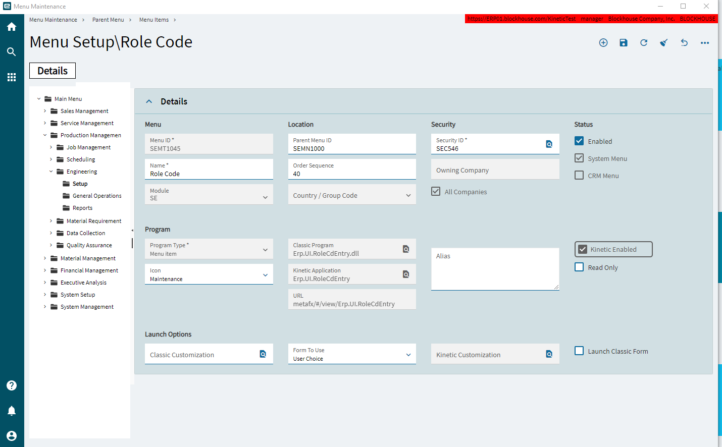

When we launch Epicor Kinetic we choose the “Kinetic” Menu style and the home page displays as such. However once we try to click on a child menu item such as “Production Management>Engineering>Setup>Role Code” it will open in the classic style instead of the kinetic. It gives us the option to try the new kinetic style which brings up the style we want but it does not default to it after.
I have found the options to change this (I believe) in the menu maintenance screen however the changes are grayed out and we cannot make changes even via the admin account. Any Advice?

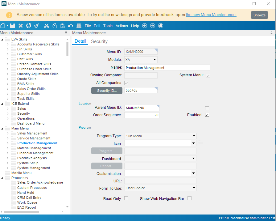

Not sure if this is true or not or will make a difference in your “greyed out” comment, but open menu maintenance from the classic client, not from the web.
Yea its greyed out on both the classic and the kinetic clients sadly
Thank you for the information I’ll see if that fixes our issue!
The form to use won’t hold the changes once we make them on the child page and if we try to make the change on the parent tier (production management) it is greyed out.
Sorry, open up menu maintenance in classic form, see if that does better.

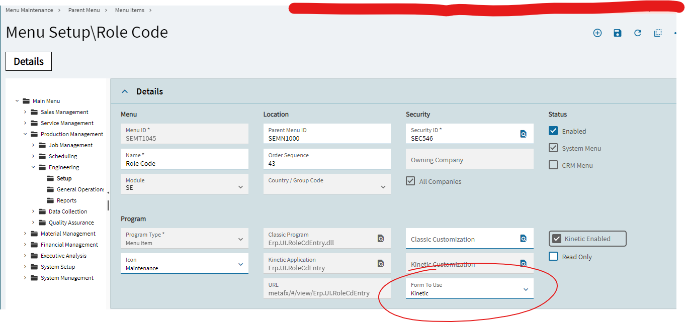

You may have to make a new menu item for menu maintenance and then change the form to use on that to be classic.
So I got it to work on the child level, but its still greyed out on the root folder level.
