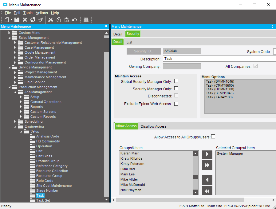

The permissions are controlled per security code not per screen. It’s hard to understand exactly what is happening without screenshots but I would suspect the user does in fact have access to the menu id they are launching via the context menu, because disallowing them on the one security code attached to the first menu id would do nothing to prevent access via the context menu if that is using a different security code.
Maybe some screenshots would help. Of Menu Maintenance, for example.

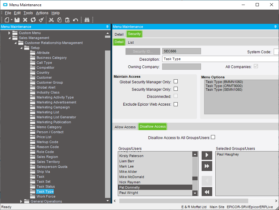

User blocked
User not blocked

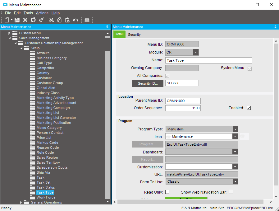

Adding the user to the Disallow access tab does not preventthe screen from launching.
The user is still able to open MenuID CRMT9000
Did you test after closing their client?
No… but I did just try that and it did not allow the user to trigger.
Good news.
However - I am still unsure why I need to disallow rather that just not allow - if that makes sense.

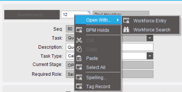

Following on from disallowing screens from triggering - can you prevent the Search from triggering:
Or better still disallow Context Menus for certain users.

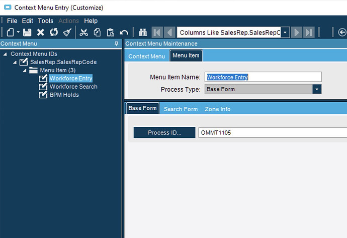

In Context Menu Maintenance you can control what options are there and what they do.
If a user doesn’t have access to what is opened from the option, then they will be blocked from opening it. (though it will still display as an option)
I’m not sure what the BPM Holds thing is for in this example, it doesn’t display for me when I right click on a Work Force ID. But for Work Force Entry, those that are on the CRM license can’t open Work Force Entry since that menu item is not available to them.
