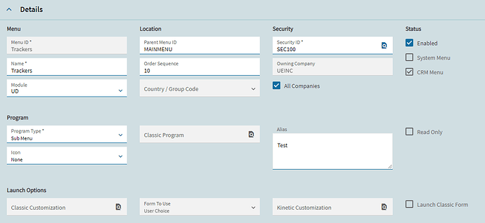

Before:

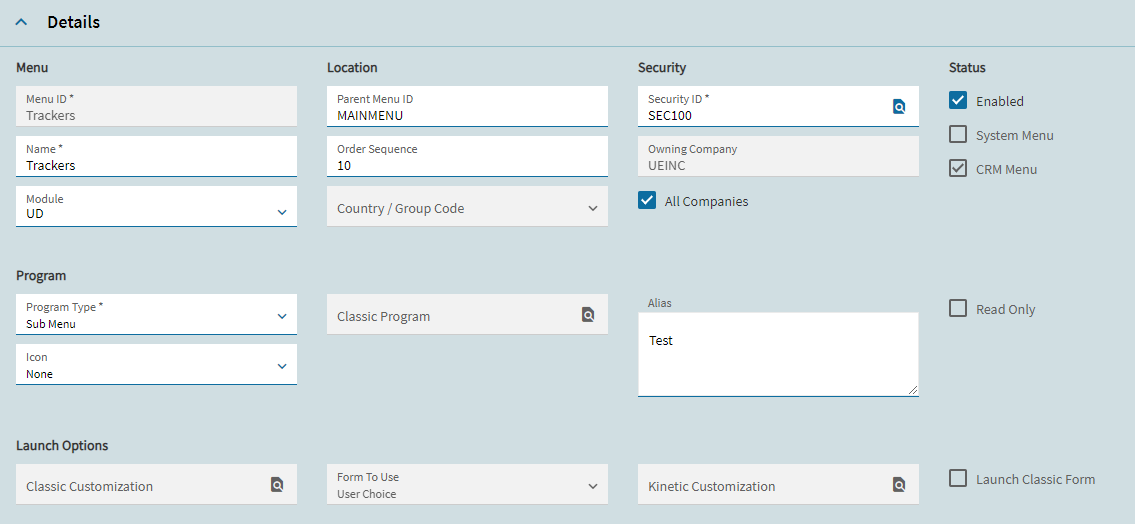

After:
Same user, nothing changed. The problem lasted since last night now is magically fixed. The only thing I had done was DMT the menus as the global admin, but that was a few hours ago and the problem was persisting after.
