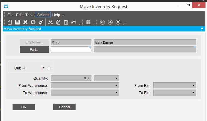

Can’t you just use the Move Inventory Request screen? It creates a queue item for warehouse to then process? Or possibly the Move Material one, but I’ve not used that. Does ask for Job No, Assy, Mtl Seq.

Chris: Mark is correct that the move request is what you want, then the backflush will consume the material. If the material list is short they can do manually or you can make requests for all of the material on the job. If you got tricky with a timed baq you could produce the moves for all jobs with a start date of X days away.
Making your own mtl queue record is not hard. I do it in a bpm in E9 for engineering to have the crib bring them material they add to a job. The move is a STK-STK from the stocking warehouse to the back flushing warehouse.
