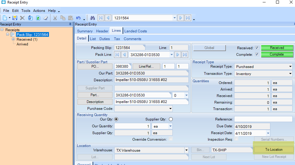

I have noticed on PO receipt that there is a “TO location” button on the PO line. Is it possible that your receiving personnel are clicking this even though it does not change the bin, it just re-enters SHIPWHSE and then perhaps creates a material move request in the Queue from same spot?
Nancy
Hi Nancy,
Thanks for replying. I think all the To Location button does is pull through the location where the items should be delivered to, it doesn’t create a move request to my knowledge.
Jonathan
