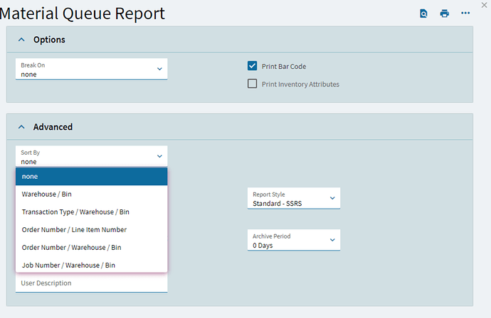

I want to properly add an additional sort option to the Sort Options.
Has anyone done this?

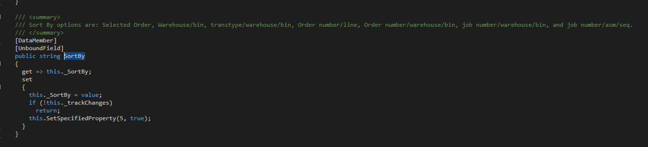

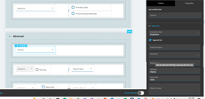

I see the following in the customization layer, but I have no idea what to put that will be meaningful to the sort options
I’m not sure you can update those.
It’s showing some pretty specific options.
You’ll likely have to make your own report if you want it sorted in a specific manner.
