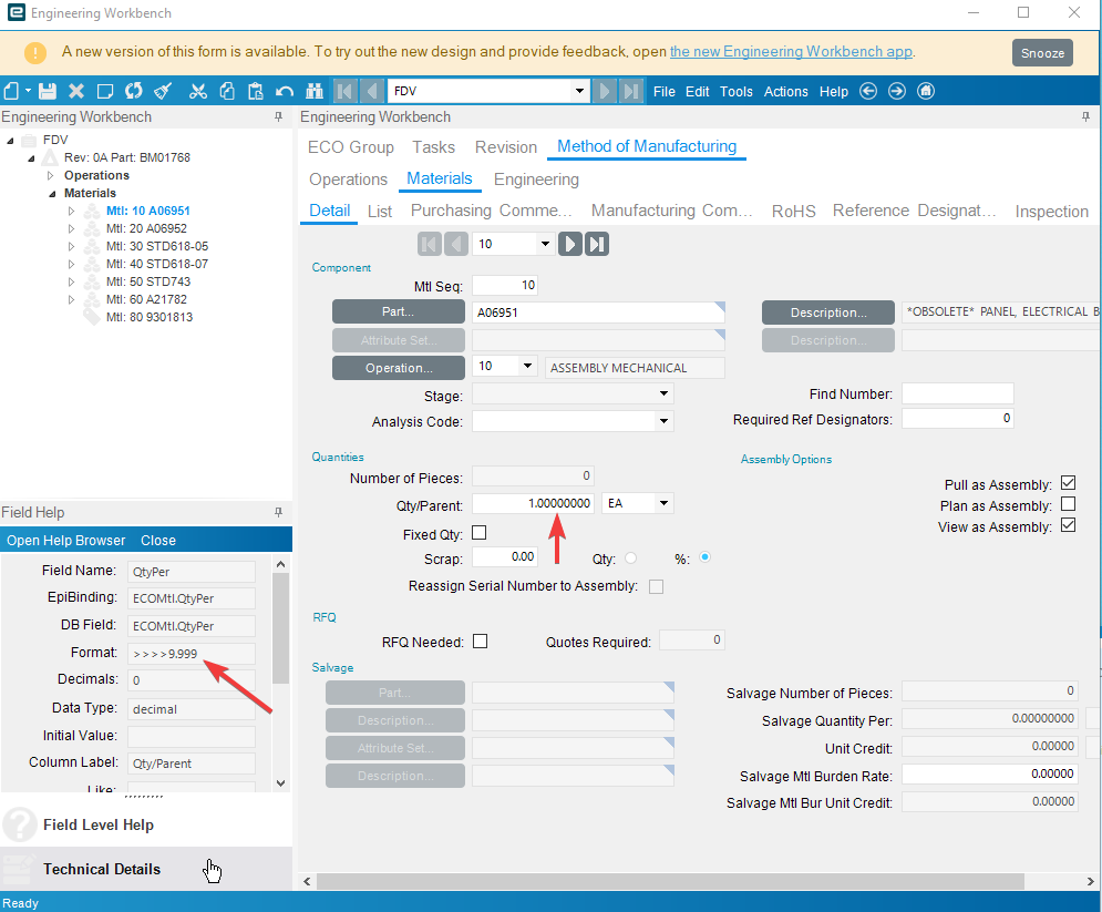

Quick question: Is it possible to change the number of decimals that are visible when adding materials to a BOM in Engineering Workbench (and Method Tracker)? Each UOM has its decimals configured correctly, but this is not honored on this screen. I also tried overriding the number format for the PartMtl.QtyPer and ECOMtl.QtyPer fields in Extended Properties, but this isn’t being honored either. My custom format appears to be recognized at some level, because the Technical Details pane of Field Help displays it.
[edit]The Extended Properties edit does work on Method Tracker. Still does not work on Engineering Workbench[/edit]

Our engineers never specify material quantity on a BOM using more than three decimals. Isn’t there way to only display three?
