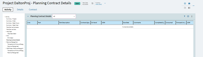

Another option you may want to look into @anon99908839 is Planning Contracts. This lets you buy materials for a particular reason and soft-allocate for that project. It’s been around for a few years and may work for you as well. Search the site here for more information.

We are using projects module. One of the selling points for this software was that we can tie purchases to jobs. Unfortunately nobody told us that in order to do that you have to have all the materials in the job itself before you can tie the PO to it, so it’s not a bi-directional deal… That really kind of sucks because of the nature of what we do… everything is custom, so 100% of the time we have to order things not on the original material list in the job itself… I thought this would be a great way for us to track unintended costs, or mistakes in quoting… but due to the way Epicor handles it, we can’t do that. It will require going into the job first, adding the material, then purchasing it… so cumbersome and really not what we thought we were getting.
If you have a Planning Contract assigned to the Project, you can buy against it instead of a Job and then you can consume it when you’re ready for it.

I’ll look at the planning contract, I did see that box in the PO form. Thank you.
