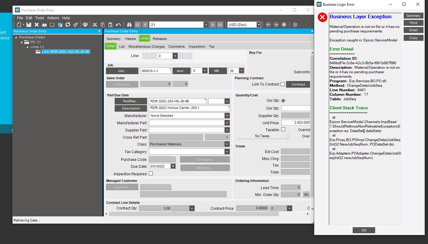

Material/Operation is not on file error
Really making a last attempt to use Epicor or not… that aside - If I create a PO for Job Material, select an item that’s in the job material list, I keep getting this error… Anyone run into this? I’ve tried using different jobs, different PO’s - same issue.
Side note I have started using the old shell UI instead of Kinetic, it’s not all that bad. It at least doesn’t have a zillion bugs.

I could be wrong, but I think you need to choose a material from the Mtl drop down list, next to Job and Asm.
Good move on working in classic. Kinetic is waste of time.
Thanks. Yes I did select the material from the drop down… the pic I put up doesn’t show that… It errors whether I select it or not.
(edit: I posted an updated pic)
If you look at the Mtl in Job Tracker, is seq 30 setup as Buy Direct?
Thanks. I tried both ways, same issue. Do I need to have an approved supplier set up for it?
I’m looking at that error message which indicates that it’s not expecting Job Material needed on the job and I’m wondering why. Is the material tied to an Operation?
Oh, shot in the dark, is the job released?
I would guess that approved supplier would be a different error message earlier in the PO. But I can always be wrong. :person_shrugging:
Looks like I might have it figured out. It does have to be marked “purchase direct” and also the job cannot be released.

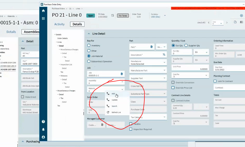

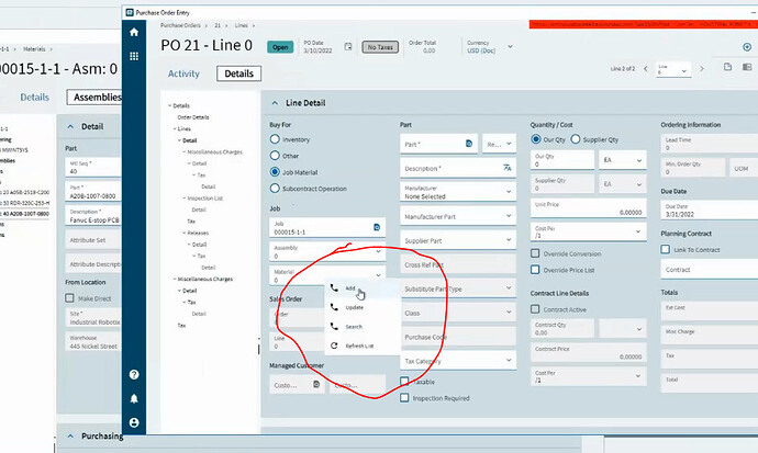

I just got a video session from my VAR…
So apparently you can add a part to a PO (for job material) that’s not on the job material list, and update the material list for the job defined in the PO…
The issue is - there’s a bug in the classic version that doesn’t allow you to “add” the material to the list…
Hahaha this time the Kinetic UI is correct but the classic isn’t
Kind of brings me back to my original issue - it’s difficult to learn and understand this software when there are bugs with the basic functionality of it to begin with lol… I’m trying to push forward though.
