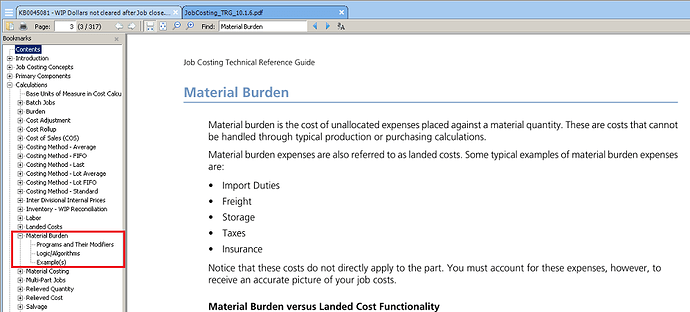

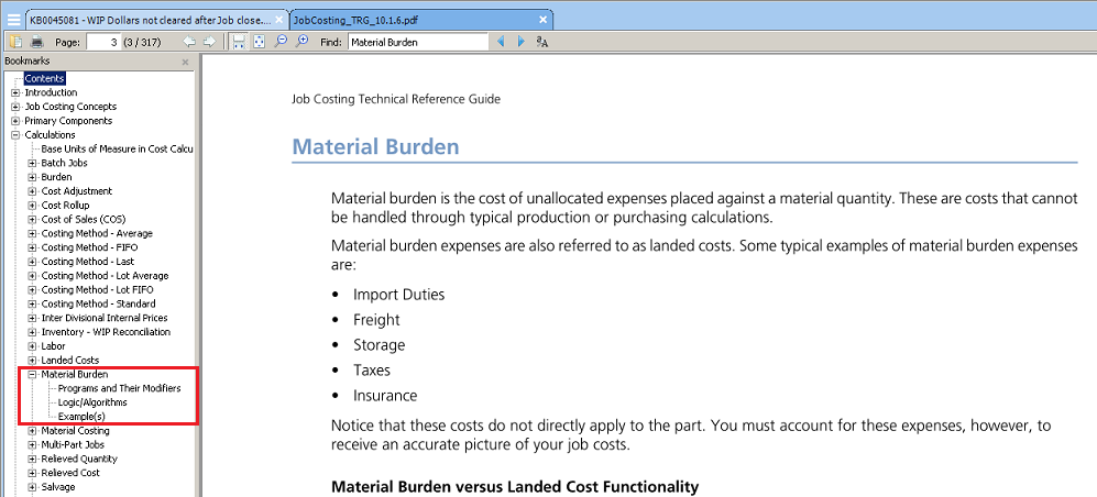

Have you already checked out the Job Costing Tech Ref Guide , section on “Material Burden”?
  • The application constantly updates material costs. It does this every time materials are purchased, subcontract work is performed, and job quantities are manufactured.
I’m not sure about K11, in E10 the JCTRG is also available as a PDF download:
