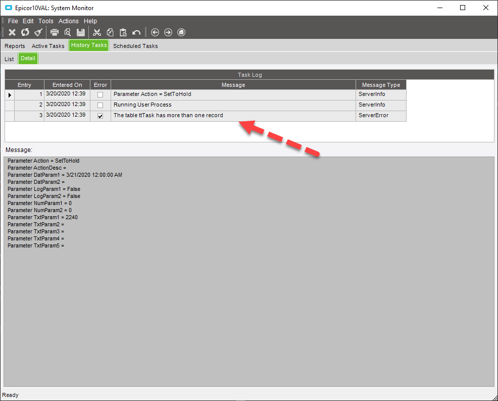

It’s getting through the Quote Update on the first record, then dumping an exception in the System Monitor saying “The table ttTask has more than one record”
Ok I got it working, it executes and changes the task of all the identified entries with this code:

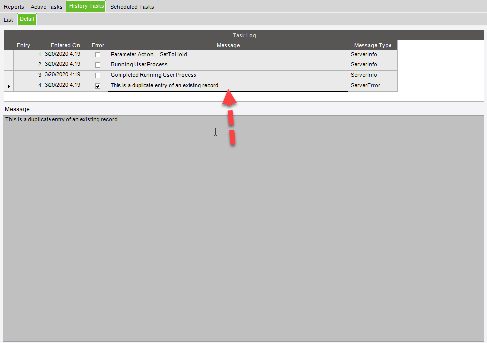

If it finds and updates a single record, no error appears.
With multiple items in the queue, even though it successfully updates the entries, I get an exception in the System Monitor saying “This is a duplicate entry of an existing record”. Any idea where it’s coming from? I’m sure its something small at this point.
Got it working, just needed to take out the method before the Task.Update method is called. That’s probably a UI specific one, at least in this simple case. If it were more complex of a task situation, would likely need to call that.
