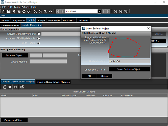

I’m in the process of trying to create an updatable baq that allows the user to update the PartOpr.CommentText field.
I do not see an updatable method/business object for the PartOpr table:
What can I use in place of a typical update call in this case?
PartOpr holds all the operations for all your revisions. I don’t think you can update it directly - it needs to go through Eng Workbench, check the revision out, then back in, etc. DMT is your best bet if you have it.
That’s what I figured. Thanks!
