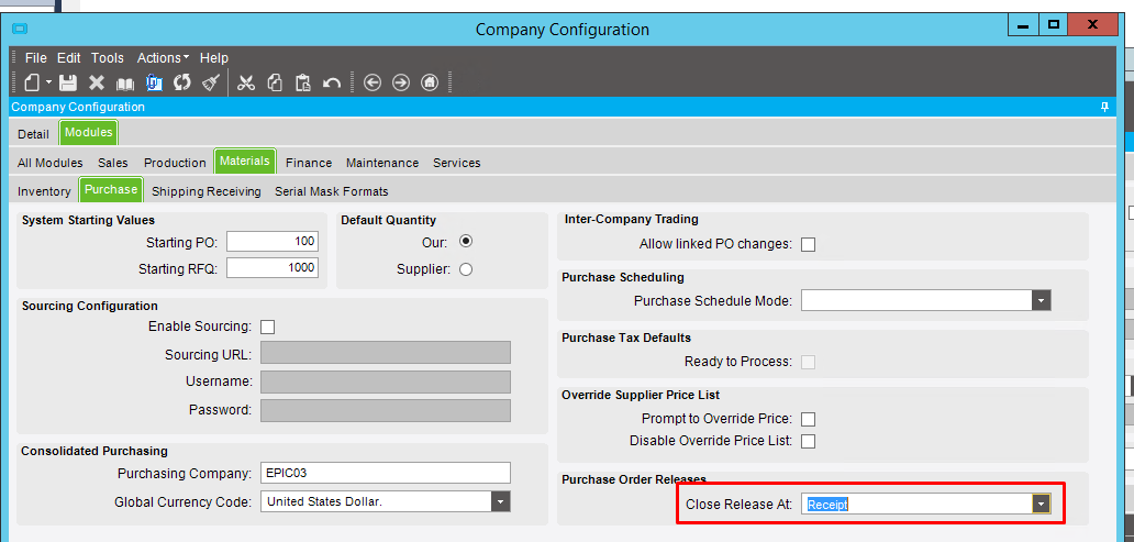

Not sure if this could help in some fashion but you can changed when a purchase order ‘closes’ with the setting…
Company Configuration / Modules / Material / Purchase / Close Release At = Receipt.
This will stop the purchase order closing when all lines ‘Arrived’, rather when they are all ‘Received’
Doing a mass receipt with close release at 'Receipt’
Setting
Demo PO
Receipt Entry > Mass Receipt
Click Select All > Get All > Process
We see the Purchase Order is not closed
If we do the same thing but with it to Arrival
The purchase order automatically closes (I just repeated the same actions above
This was done on the Epicor Demo Data
