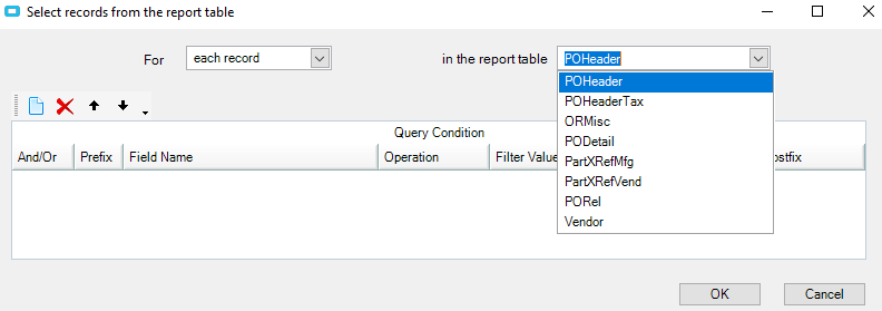

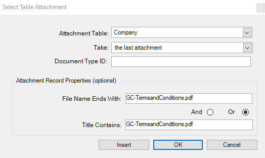

This is the rest of the Take DocStar attachment config. I do not see where I can or need to enter ā€œin-scopeā€ either.
This UI shows the tables of the report you are processing, so it should not contain table Company.
The idea is that you take row from your report table, probably POHeader, then use value of that row in the Take Attachment.

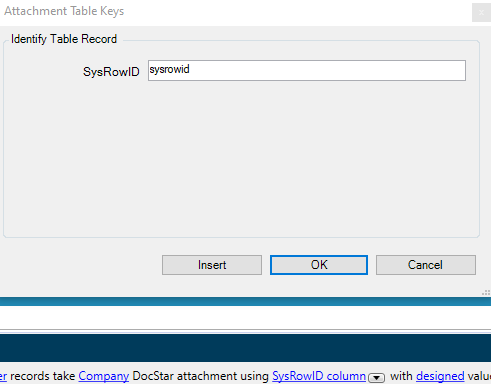

I think you need to change SysROwID column to another value (Keys?) and then specify that key value, in your case just Company value.

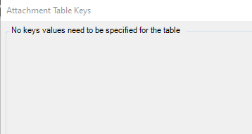

If I change to key fields and the click designed value, it says No keys values need to be specified for the table.
right, because Company value is taked from session, and it is the only key field for that table.
Will it work like this? Obvisouly only one company will be used.

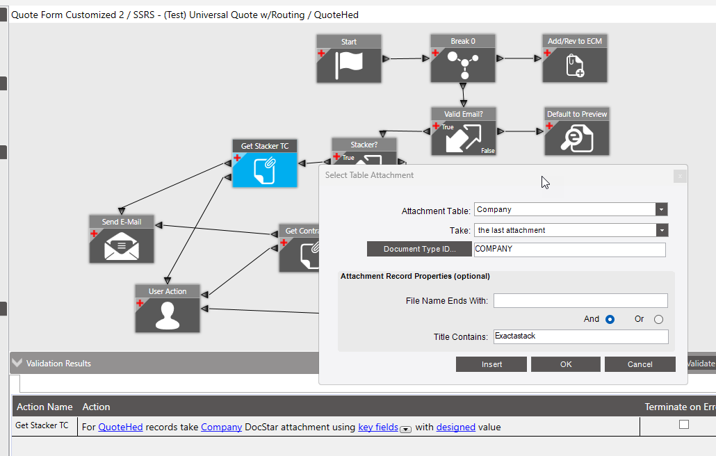

Here’s what ours looks like. The ā€˜designed’ value is blank. Breaking is done on Quotenum.
