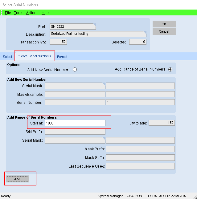

The PO Receipt of Serialized parts lets you generate the S/N’s when receiving the line.
And it is better to create the S/N’s received, than to assume they match the ones you requested. Unless you’re trying to add a check that the S/N’s received, match those requested.

Nothing standard. I’ve done this in E9 as a customization to PO Entry. Basically "generate serial #‘s’ will go through and create serial #'s using the standard serial# logic/mask, and set them as ‘adjusted’. Then change them all to another status that can be selected at receipt entry.
I don’t think you can create a S/N for a “yet to be received” part, for selecting during PO Receipt Entry. Only on parts to be manufactured.
