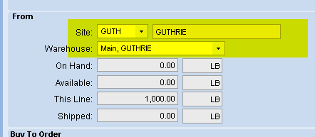

We have 4 sites, and sales often needs to change the “From Site” on sales orders. Normally the site you launch Order Entry from is the default site for “Form” on Order Releases. If you want it to ship from another site, then you have to manually change the Site and warehouse.
This requires selecting each release of each line, and manually changing it. Some orders can have 200+ lines.
I tried un-hiding the “WarehouseCode” field on the grid in the Lines-> List sheet. But that doesn’t seem to link to anything. I can search for a warehouse code and select it. But as soon as I leave that row, it reverts back to blank.
