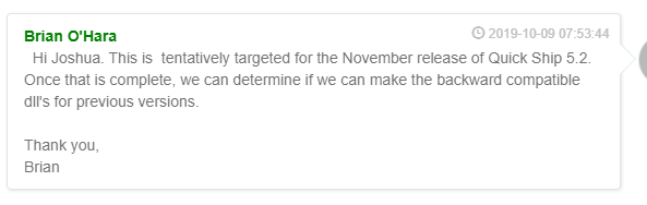

Also response from Support below on the surcharges portion.
