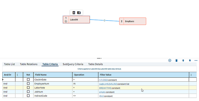

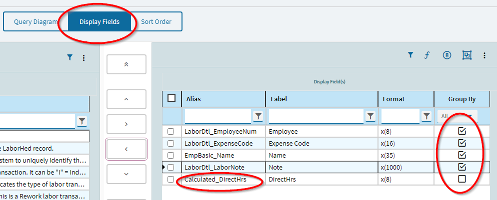

seems fairly simple in a baq… You need to add the appropriate tables, add the criteria, and the display fields… you need to mark the group-by for all the fields except for the calculated field that does the SUM of the Labor Hours.
Note that you also have to join the EmpBasic table to the LaborDtl table to get the employee name that you desired to be displayed.

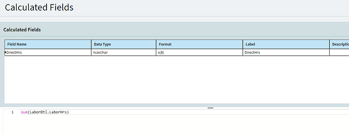

THEN add the fields you want to see in the Display FIelds section, but make sure that you do the calculated field for the value you want to sum:
Here is the calculated field:
