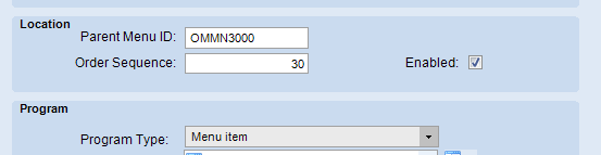

I have created a customized version of the Order Entry screen and created it as a second menu item. Our users can see the menu item, but cannot open it. Here is what I have done:
Customized the OE screen to add a UD field.
Saved the customization as ECPO
Created a new menu item (under menu maintenance) for Order Entry - ECPO.
The new menu item has the same security ID (SEC078) as the system Order Entry menu item.
The only difference I can see between the original and the ECPO version is that the System Menu checkbox is checked for the original one.
Users can see the menu item, but when they click on it, it won’t open.
Any ideas on this? How do we make it available so others can use it? I can see the menu item and it opens for me but I don’t know if that’s because of my permissions (I have very broad permissions) or because I am the one who created it.
Thanks.
—sam
Just throwing this out there in case it was overlooked (sometimes, it’s the simplest things…) Is the Enabled checkbox checked?
Thanks. Yep, it is. Was speaking with one of my colleagues and she thought there is a publish function, much like when you deploy a dashboard. So am going to look for that next. Did not see it in the training materials.
Thanks for the thought.
