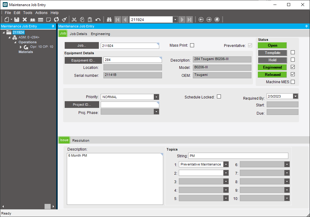

Thanks @balmon for your suggestion. With the Maintenance Module, actual maintenance jobs look nothing like inventory jobs. You don’t see any of the fields you would for a standard production job.

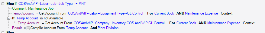

If you go to the equipment can you setup a GL control for the equipment type that is assigned to the piece of equipment? reading the posting rules it looks like that’s where it will check for Maintenance jobs:
