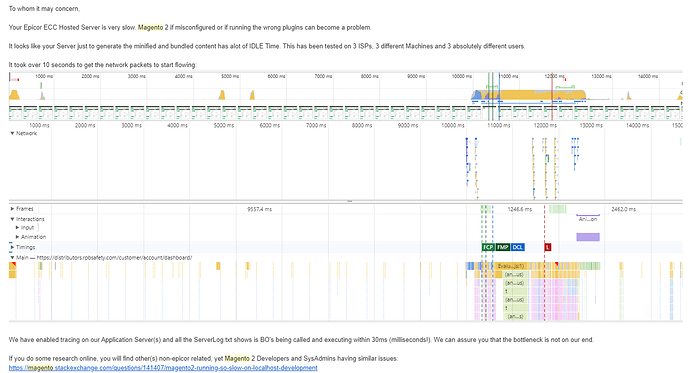

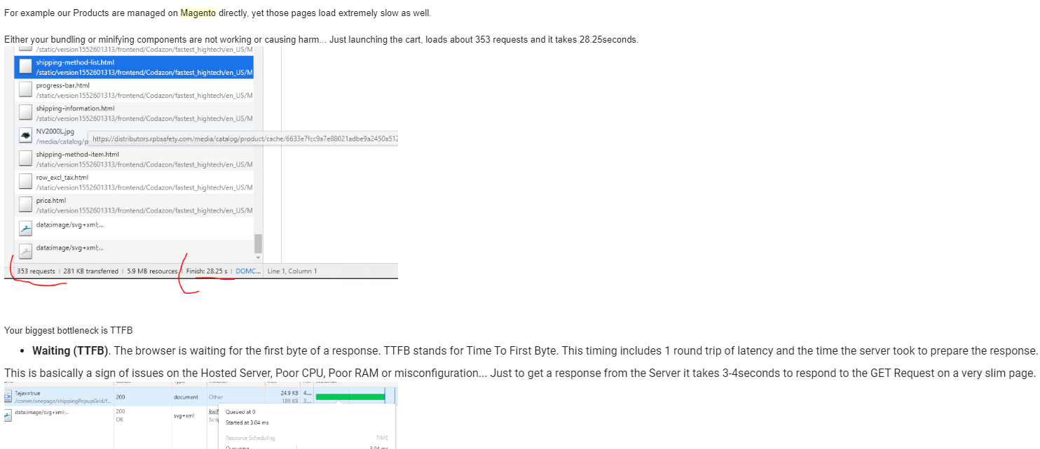

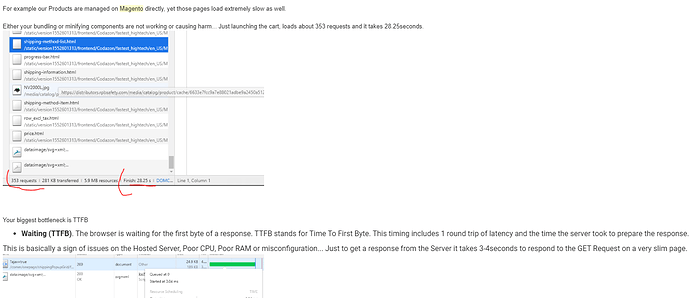

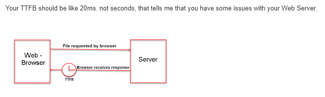

Sounds like a Magento / Server Issue… Where are you hosting?
If I remember correctly Epicor < - > Magento isn’t real-time. Magento and Epicor Sync on a Schedule but the entire Magento UI runs purely on Magento and doesnt ping Epicor at all (unless they changed that).
I remember running Magento 9yrs ago and even then on a Dedicated Server it was slow. What are your server specs? If you are hosting with Epicor, I have seen their Servers be awful for Magento. Even the initial page load hosted by Epicor took too long.
I recall even sending an email year ago.
Average Time to First Byte is 100-500ms. Google says to aim for 200ms. Epicor ECC Hosted was like 5000ms - 15000ms.
I also recall having 200+ ShipTo’s killed Magento Performance.
