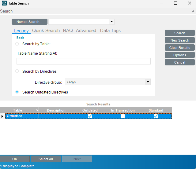

The other option would be to run a query like this to see if it’s just marked as outdated:
SELECT	*
FROM	Ice.BpDirective
WHERE	IsUpToDate=0
If you want to try the last one in your system you can do this when searching for the directive:
If you are multi company, I would suggest the SQL.
