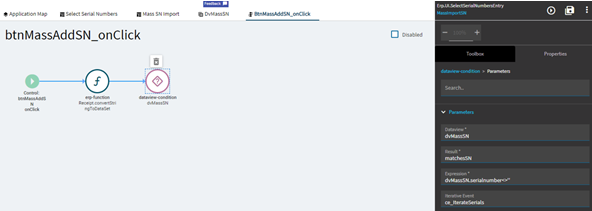

Isn’t that what the dataview-condition helps with? Think I have an example of looping through a dataview and calling a function, but I am guessing you can update a local dataview as well.
Then you have the “ce_IterateSerials” custom event which processes your loop.
Yes you can achieve a foreach loop using dataview-condition.
This is the example I followed.
