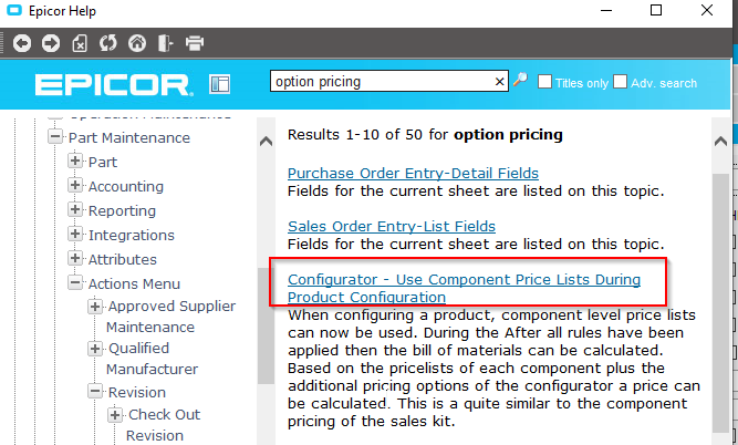

Thank you Tim. I found this in the Epicor help:
Can we use that? I don’t see a pricing options panel in the configurator. We are on 10.2.200 and going to 10.2.700 soon.

Component pricing is essentially only for sales kits. We went down that road and ran into some major limitations.

I looked back at my notes and remembered what the showstopper was for us with Component Pricing.
If a BoM contains more than one of the same configurable subassembly, Component Pricing applies the calculated price of the first one to all of them, regardless of differences in configuration. This was acknowledged back in September as PRB0238807.
