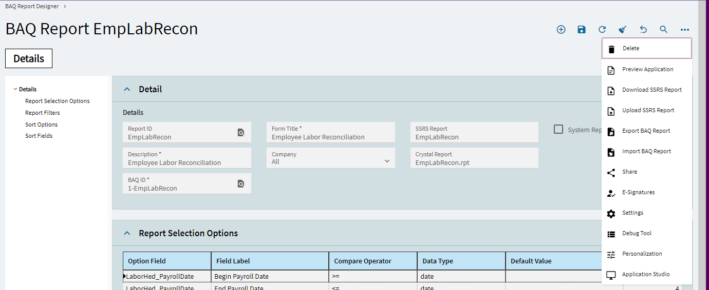

Hey, I made a copy of a BAQ Report to make an .rdl file. I am unable to upload that .rdl to the original report. Clicking the button tries to load the prompt but it goes away.

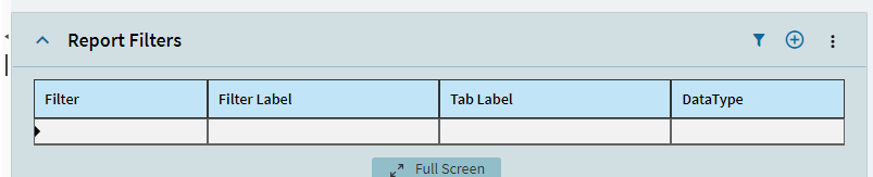

If I try to add a new filter to the copy, it makes a new line but typing anything or clicking on the dropdown menu locks the new filter and tells me Error and that I need to fill the boxes, but I can’t.
Just to check, I did make a brand new BAQ, named it and all but as soon as I try and edit the filters, it still locks up.

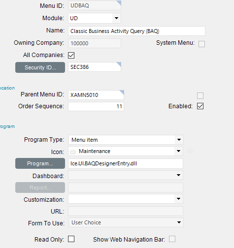

I created another menu item called Classic BAQ and mapped it to the Classic dll until the bugs can be worked out of the Kinetic version.
The BAQ I made, I can’t add options or filters while in classic mode either. It is like its locked out. I had another person try too and its locked for them as well.

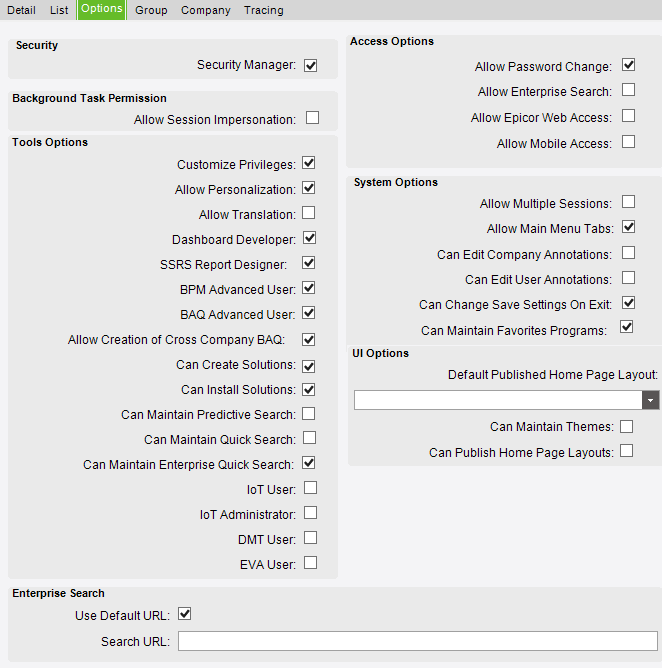

Check and ensure you have BAQ Advanced User set on your user account in User Account Security Maintenance.
I have that already
