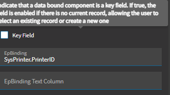

- Combo Box Configuration
Epi Binding to SysPrinter view & dataset

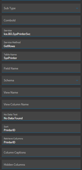

Re-Usable Combo Config

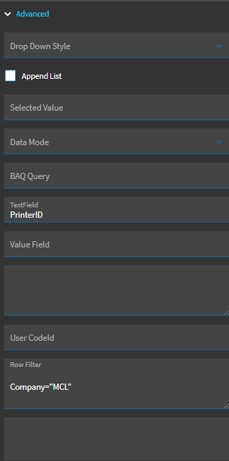

Advanced Section

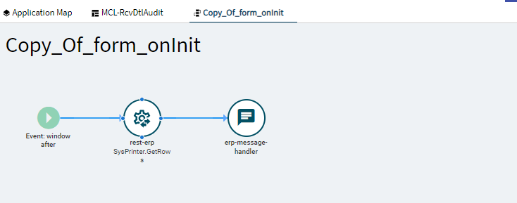

- Initialize dataview SysPrinter using Rest-Erp widget:

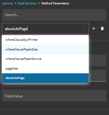

Method Parameters:
I see the get rows automatically pulls method parameters. Is it best to set a static value field or should these be set to columns of the dataview?

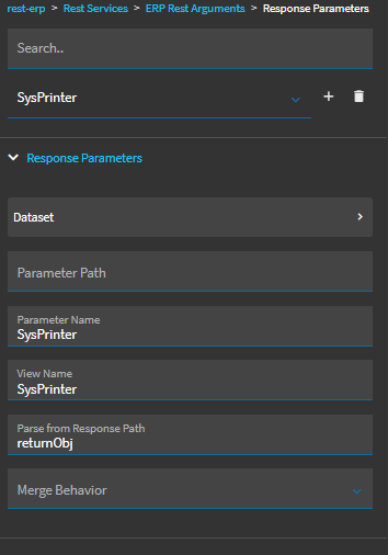

Response Parameter:
