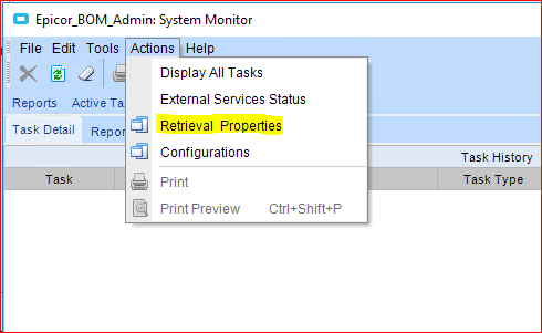

I can run tasks and print reports, they show up and complete, even get the ballon popups when they complete. However, I can’t get anything to show up in the system monitor after it prints, it’s just blank. When the task is active it does show up in the Active Task tab, but nothing in the Reports tab or the history tasks.

if it is in minutes change to Days
@surendrapal, thanks for the quick reply, however it’s already on Minutes…
Nice thought though!
set Minutes and save again in days
Same thing :expressionless:
Opened Retrieval Properties, changed to minutes, clicked ok, opened again, changed to days, clicked ok, and clicked refresh, still nothing…
