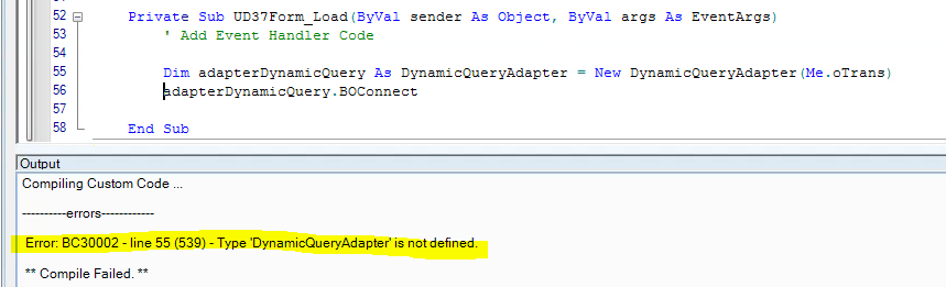

I found some code here that states it was working, but being a novice, I am likely not doing this right.
I have a UD Form and have a button. I copied the Event Wizard and now have reduced to 1 error on compile.
Compiling Custom Code … Line 71 is highlighted
----------errors------------
Error: BC30002 - line 71 (273) - Type ‘DynamicQueryAdapter’ is not defined.
** Compile Failed. **

Hi Miguel,
You have to add a reference to the adapter first.
If you get that, you need to use the wizards to add a custom reference.
Pick the first option
Get adapters list and pick the dynamic adapter
It will compile successfully now.
Carlos
PSE
Thank you, that made the code compile.
