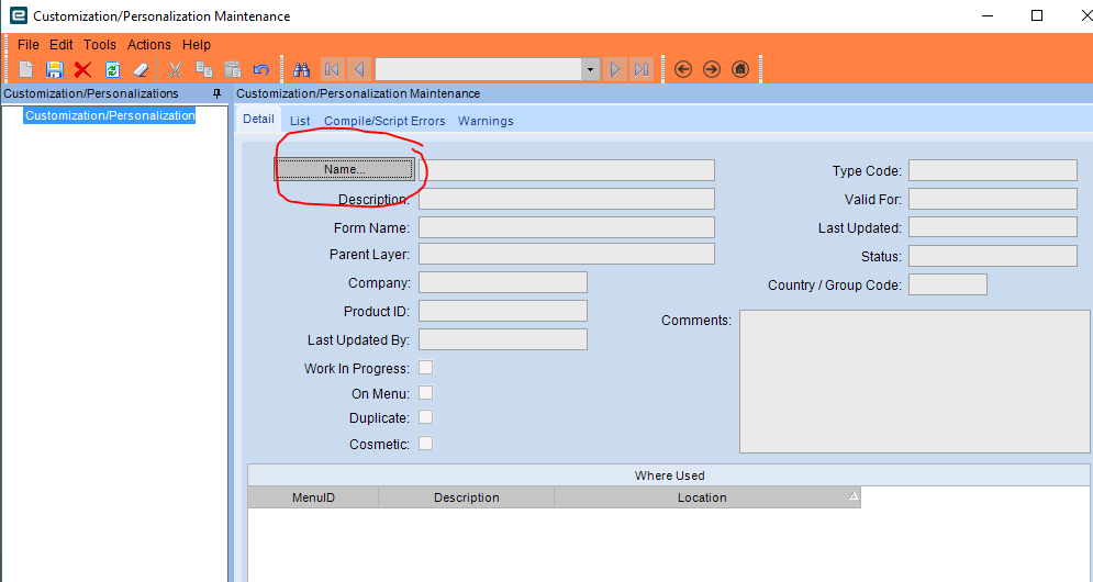

Open Customization Maintenance:

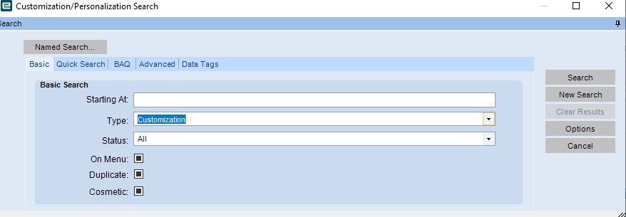

Click the name and search for Type: Customization
Select all then go to the list view.
That was too easy! I totally forgot about that menu. Thanks so much.
