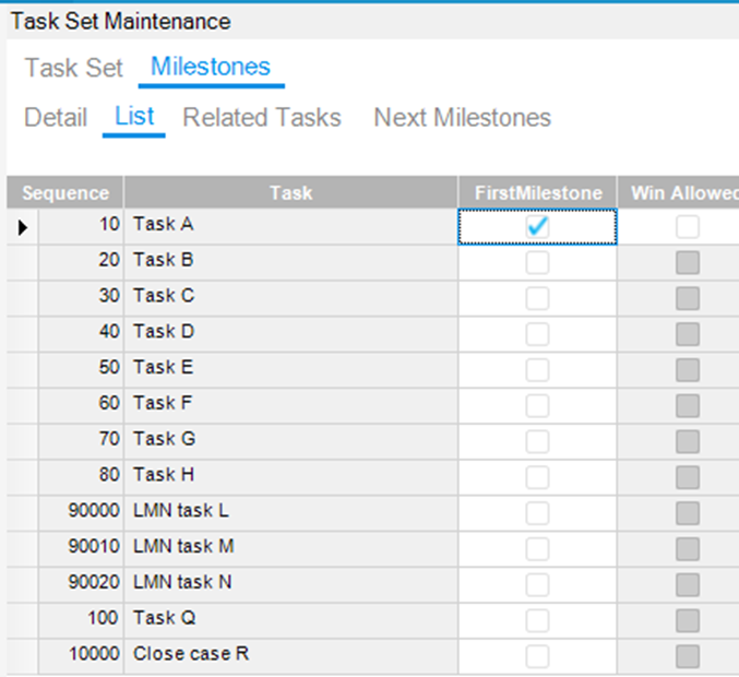

Here is an example. Assume the following:
  • Task Set has tasks A-B-C-D-E-F-G-H-Q-R.
  • Sub-process LMN can be optionally included between Task H and Task Q
  • Task R is Close Case. For us, it is the same last task for every case.
So, the milestone setup is this:
Close case R is always sequence 100000.
The LMN sub-process is a set of high numbers that will never get in the way of standard tasks.

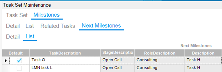

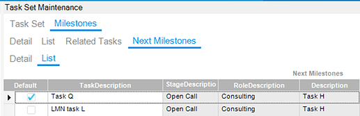

Task H has a choice of next steps – either straight to Q (default) or out to the LMN process.

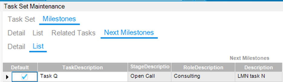

Task N has Task Q as its next step in this task set. In another task set, it might be different, depending on where the LMN sub-process can be inserted.
We use DMT, so I keep the LMN milestones in Excel and can drop them into any task set. I have to tweak the next step for N each time, but it beats having to re-create LMN every time. LMN is frequently way more than three tasks.
