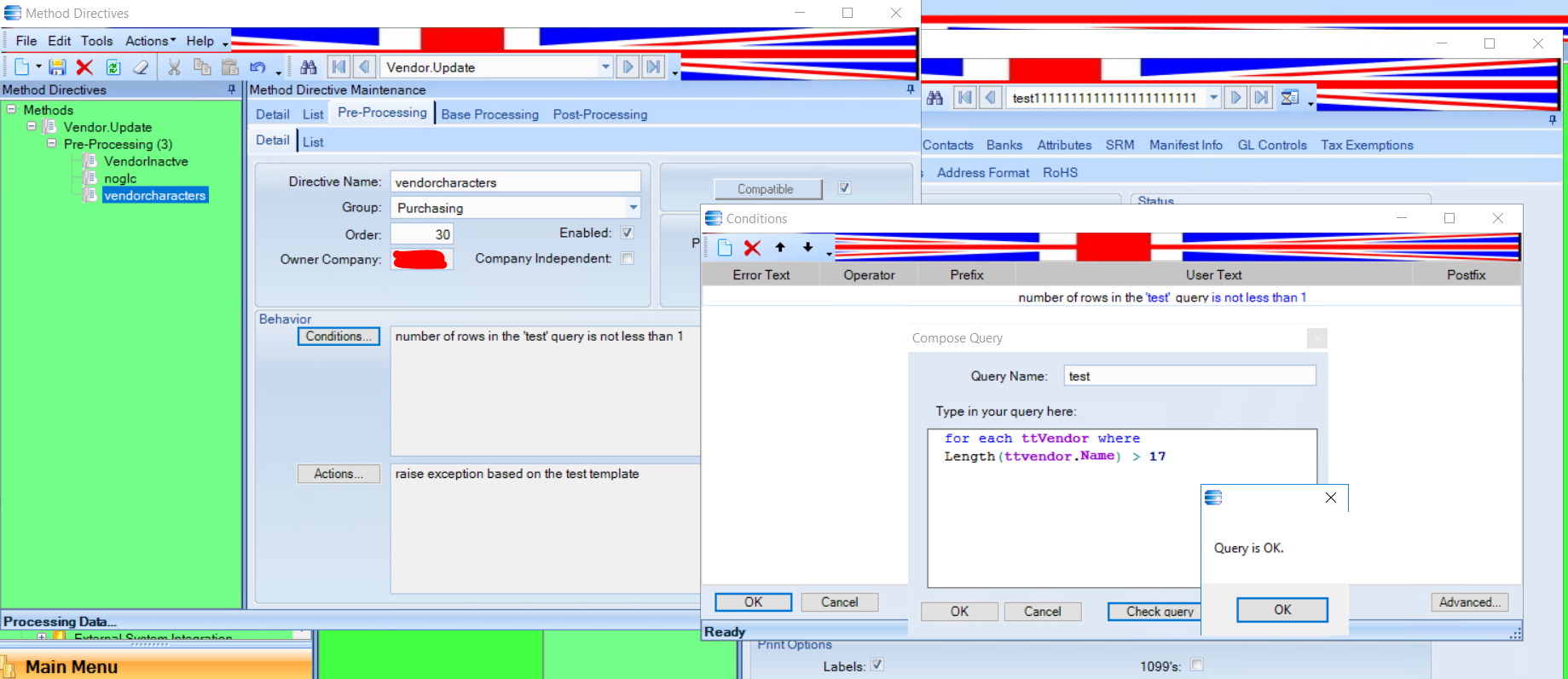

BPM I’ve tried: Method Directive/Vendor.Update/Pre-Processing using “number of rows in the query is not less than 1”.
Issue: I think the syntax just needs fine tuning as it appears to be erroring on everyone even if its less than 17.

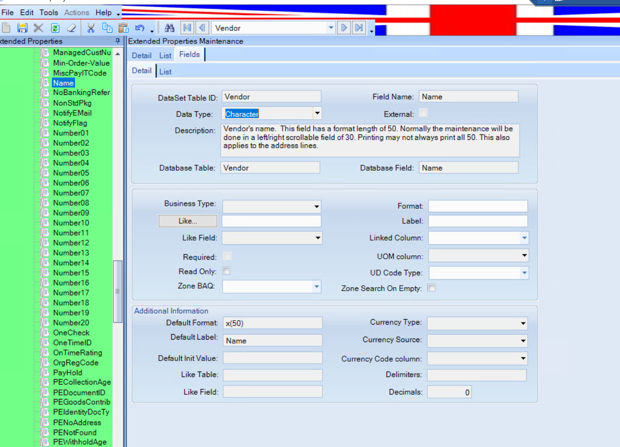

Extended Properties Maintenance you can set the limit there with no code.;

But back on original question… Try trimming (via TRIM(), or RTRIM() ) the ttVendor.Name value before checking it’s length
Edit: Or try the much easier thing Jose suggested.

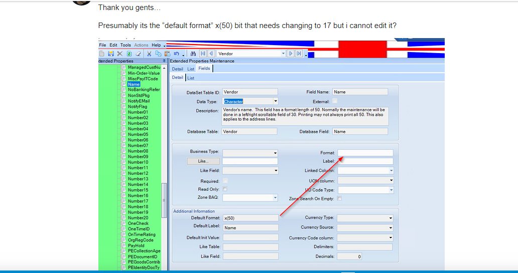

Presumably its the “default format” x(50) bit that needs changing to 17 but i cannot edit it?
Top right the Format field you can change it X(17)
perfect
thank you
this applies it to ALL companies (we have 4 subsidiaries)…is there anywhere to ensure it is just applied to one company?
Not this way… You’ll have tod o the same thing (but at the customization level)
IN customization -> Tools -> Wizard -> Extended Properties you can set ti there
