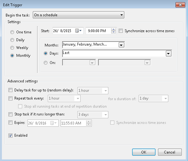

or this?

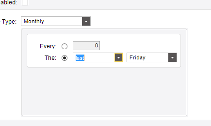

Not following on the UD table/rest design to get “last day of month” as a schedule. Also the ss shows last friday :wink: if It had an option for Last Day of Month, it would be fantastic
Last day is tricky. You could probably write a little utility that figures it out and update the system agent schedule number in question with the appropriate value, then run that little utility on a schedule option that is more easily available.

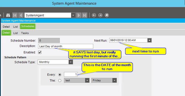

Why not simply run the process the first minute of the first day of each month. This way, you are essentially running “in between” months.
That is pretty clever, but unfortunately it needs to run the morning of the last day of the month. The other part I need to figure out is how to pass different execution parameters like date ranges in. Working on replacing an existing Ssrs report and subscriptions with a BAQ…

It appears that there’s a built-in “last day of month”.
Setting a schedule for: Monthly, Every 31 will do what you want.
Here’s the schedule, with next run of 5/12/19 at 4:30 PM (a few minutes after I created it)
And here it is after it fires.
Note that it set it to the last day of the following month. In this case June 30 (not June 31st).
And it maintained the time portion. So if you want it to run at 6:00 AM on the last day of the month:
  1. Schedule Type: Monthly
  2. Every: 31
  3. Set the next run to 5/31/2019 6:00 AM
It should run at 6:00 AM on 5/31, then set its Next Run to 6:00 AM on 6/30.
