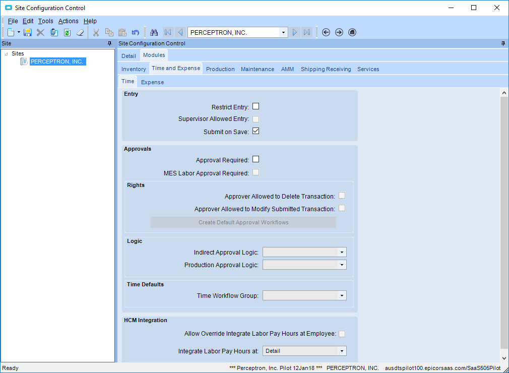

Status “E” means entered but status “A” (for Approved) is required. Not sure if you use Auto-approve with your labor or have supervisors approve it.
Mark W.
Auto-approve?? Ok, (cringe) Newb question…where is that at?
