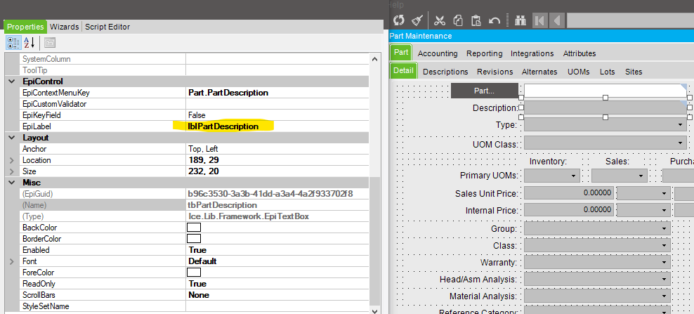

Yes. There is a property on the textbox that I believe is called Label or EpiLabel and you can select the label from the drop-down. Then they will remain linked.

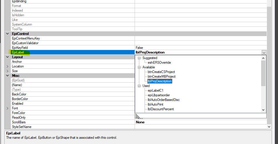

Yes, you select the label control by name in the EpiLabel property of the text box control:
The label won’t change size if it’s associated control changes size, as far as I know, but it will follow along if you change the location of the control.
